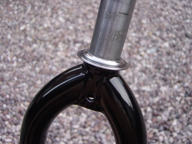

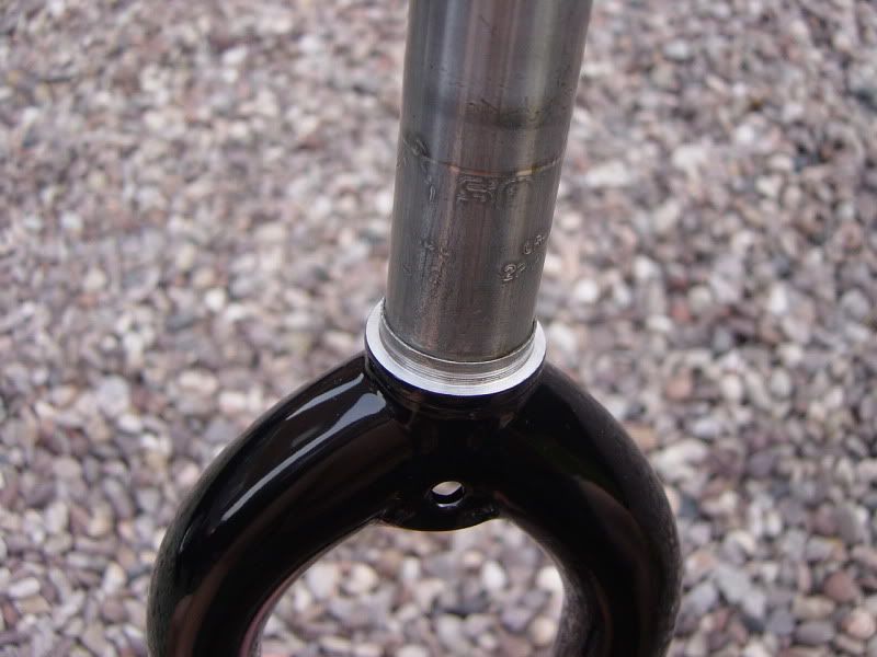

Well my friend came up trumps with the loan of the tools again 8) so the crown race seat was faced, the powder coating cut off really nicely leaving a perfect edge, no chips etc :
I checked the sizes of the race and seat - both were well within spec (not that there was a lot I could do about it if they weren’t :lol:) so the M900 crown race was fitted :

I managed to give the forks a quick polish before bed and as I was up early this morning (through no choice of my own :lol:), I now have them fitted along with a single cantilever, it was so so tempting to be late for work … :lol: As expected and as per the last time it was fitted, the XTR unit with loose balls is silky smooth 8). I cut this steerer about 2mm longer than the original so it’s a better length now (to suit the ‘thick’ headlock) and its left me enough room to pinch one of the stainless shim washers off the ProFlex to stop the cup and headlock eating into each other. As the replacement forks are identical to the knackered ones (even manufactured the same year) they share the same design cantilever bosses and as such the recessed washers I made have fitted well without the need for adjustment / replacement
