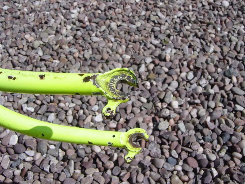

Well it was another good day with the build :-)

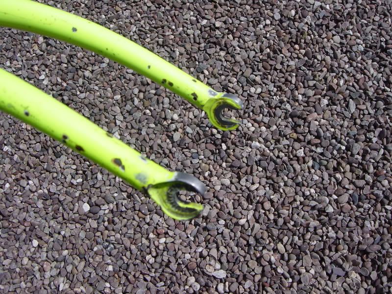

It started with the eyelets falling off the dropouts :lol: from this :
To this (crappy picture alert :lol: ) :

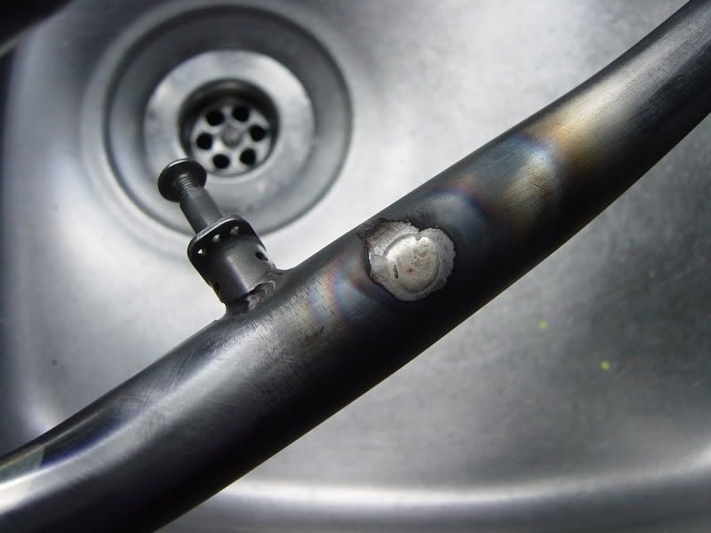

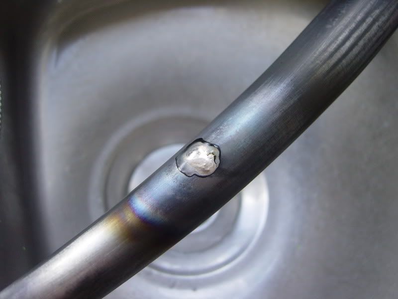

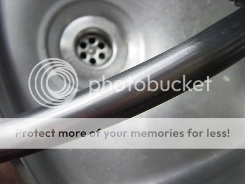

Then I thought I would have a go at brazing the dints ... I took a bit of a flyer and tried on the actual forks I am using :shock: I had done a bit of reading up on the net and wasn’t quite sure if my torch was going to be hot enough (butane / propane mix) but as the steel tubes are relatively thin walled they heat up OK / quickly.

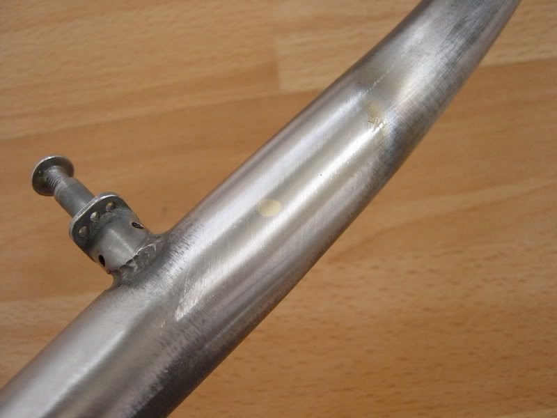

After paint stipping the forks I found a few more small dints so I tried one of the smallest ones first. Note my brazing area, the sink :lol: :
And then flatted back :

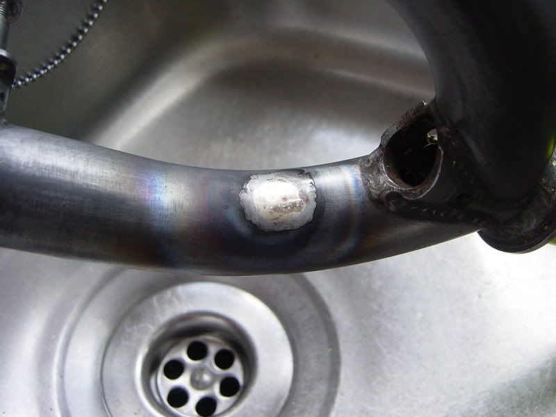

I was pleasantly surprised with the results (my first ever go at brazing) so as I gained confidence, I tackled the larger dints :
And then :

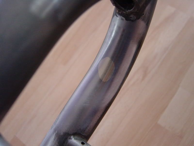

And then the big one, the braze area is long as there was a few tiny dints close by and the braze areas run into each other :
This photo was taken to show the reflection is true (the black line is the upper fork blade) – as the forks are going gloss black they need to be perfect as the colour is very unforgiving to imperfections :

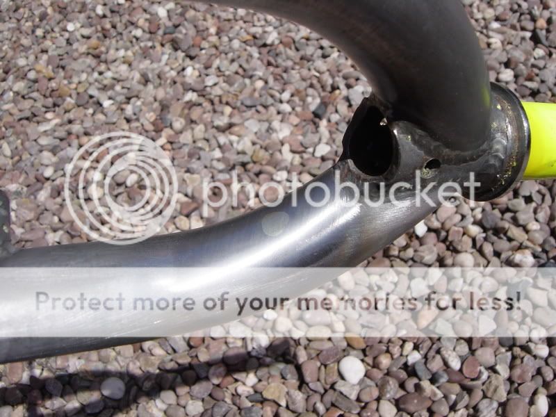

I was very happy with how they turned out, just need to finish dressing up the welds / dropouts etc and remove the crown race now :D

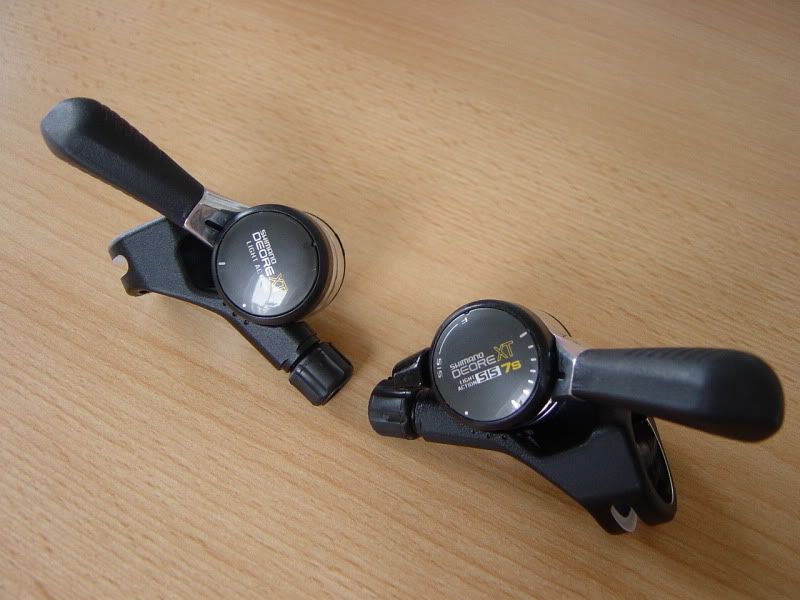

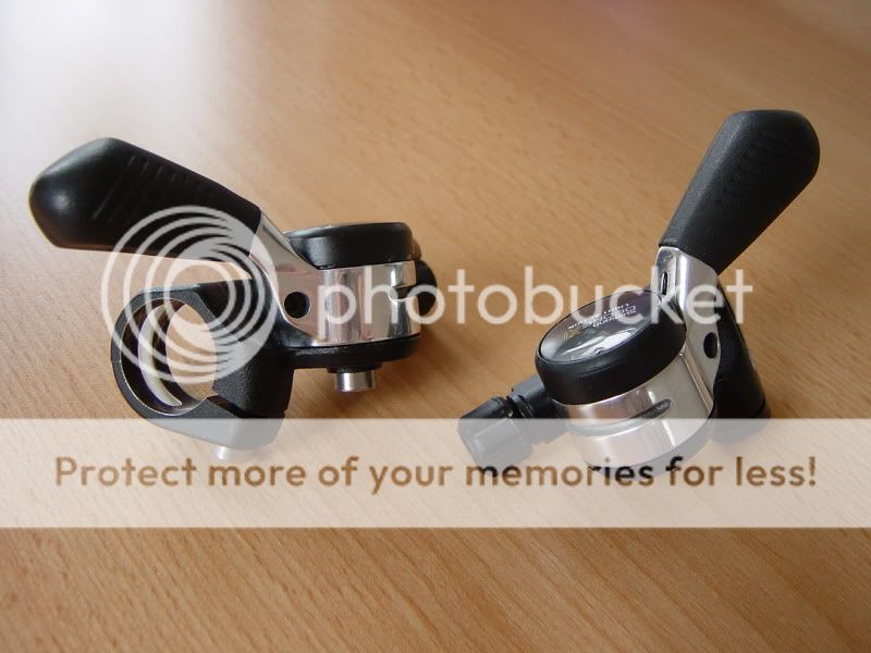

Swaped all the thumbie bits over to make the the best set I could. Some bits from Canada, some from Austria, a bit of polish, the modified clamps, stainless bolts and re-zinced springs and adjusters :

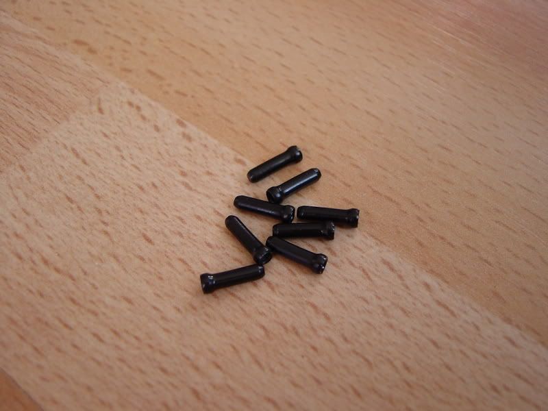

Some black bling for the cables :

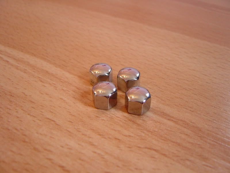

Found these to go on the back of the canti studs, stainless steel so they polish up nicely :

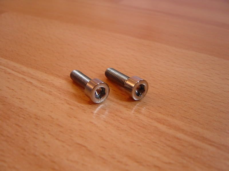

Polished quite a few Ti bolts to, these are for the bar ends, more in the stem etc :
The forks are fully dressed up now and ready for powder, If I can get to the couriers they will be going early next week :D
