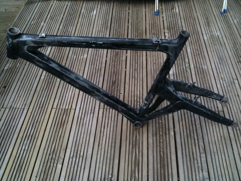

They will soon be holding up the front end of one of these, depending on the steerer tube length of my other set:
