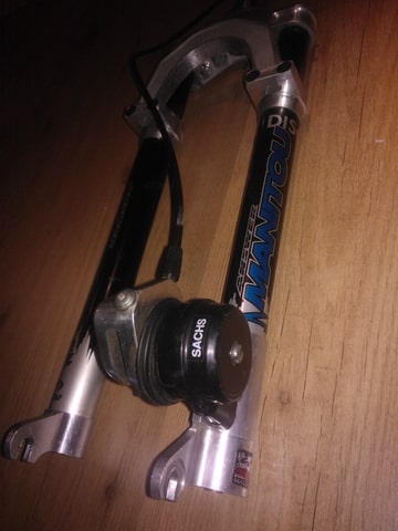

I think the disk mount fork was for a Sachs brake but can't remember for sure, or maybe it was for a Hope.
Hi,
as far as I know both M3 and M4 were made in a disc version.
Both meant to mount the Sachs Power Disc
Here is the M4 version:

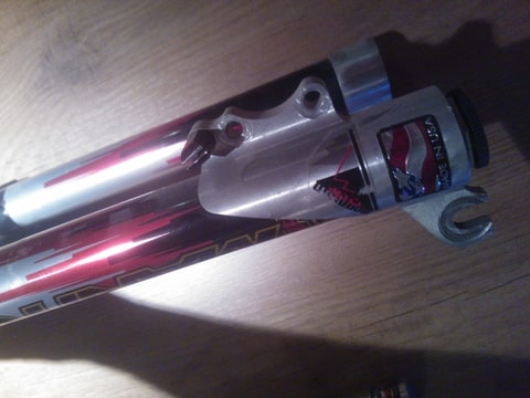

The EFC also came in a disc version. These were to fit Pro Stop
for Mountain Cycle:
Both M3 and M4 were build with black and gold inner legs.
Don't know the reason for that.
Second to the Mach5 1996 also featured an EFC with a modified
brake booster and re-done colour-scheme.

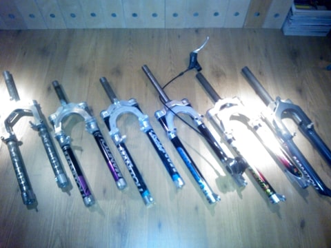

Here's a line up of some of my Manitou forks:
Cheers
Jeroen
Thanks !
It is just a part of the collection. There's about 35 more ;-)
Some in parts, some mounted onto my bikes.
The M3 and M4 are my favourites. Allthough I like the varios
EFC's aswell.
Cheers
Jeroen
