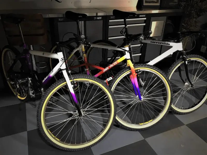

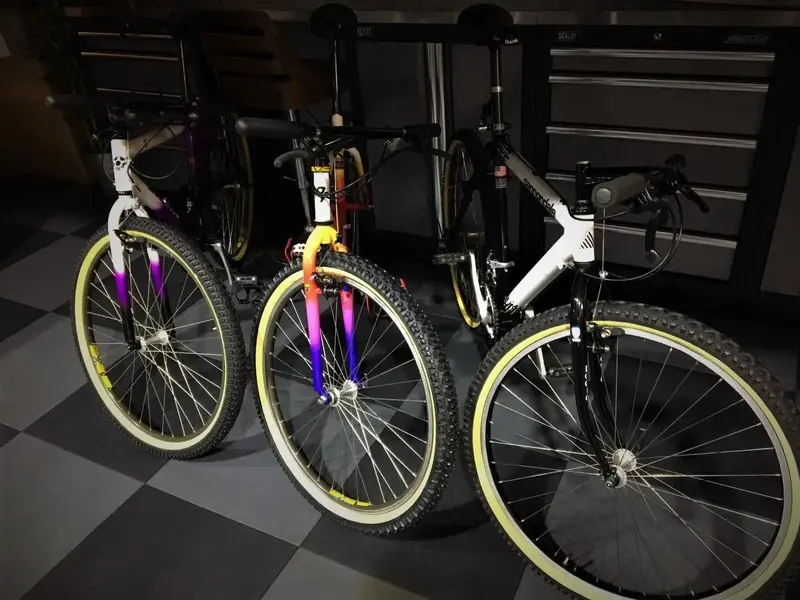

I think its hard to give a judgement on a bike without making some comparisons, the nearest for me being the Cannondale SM1000, again its sure not up to Klein levels, but then, being fair, the Dale, is Hand built Aluminium with a steel fork, but again the Cannondale is a whole bike for the price of the frame from the Mammoth stable BITD.
The most noticeable difference was the pin point accuracy and the end build weight, but again I feel this is reflected in its price point.
I found its the sort of frame that asks for more. It wants a suspension fork, it wants to be ridden harder, its so light underfoot, it wants you to punish it......(i keep "wishing" i was 21 again - I fear its beyond me these days).
I guess to sum up ... the next step, is to fit the inevitable suspension fork, the option had to be a Manitou for me, and i think I've finally found the right crown and steerer, a set of 90 Xt clipless pedals, I've yet to refinish the Salsa stem which i hope to be perfect for it, the brake cables of course and the rest is just mechanics.
Bitd I would have pinned this bike between a Cannondale and a Klein, the deciding factor would have been the depth of the pocket and the inevitable e-stay question...? Certainly far more boutique than either of the others imho..!
better...?
no, Just different
and in a good way.

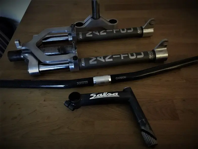

I agree with your thoughts on the forks, they certainly compliment the paint work, but now i have found the right steerer i just gotta fit the forks to find out if it really does perform as i would hope, the stem ive found still needs refinishing in black but im hoping the reach is right, and thanks to Nick an NOS Nitto Carbon bar can now also be fitted, but i do still need to find the 2.0mm XT cables... :facepalm:

Cheers Brocks, Ive painted the Salsa Stem now, so will add the Manitou and the other bits in the new year when i get five.
