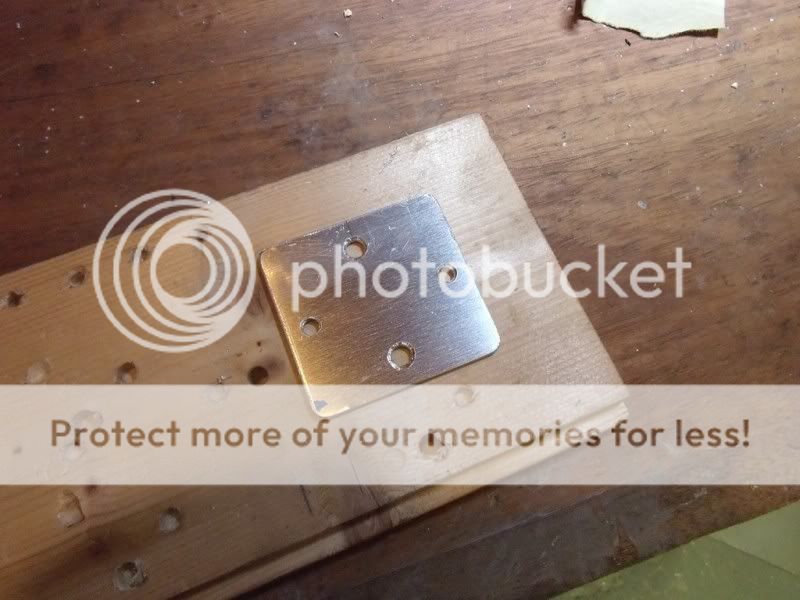

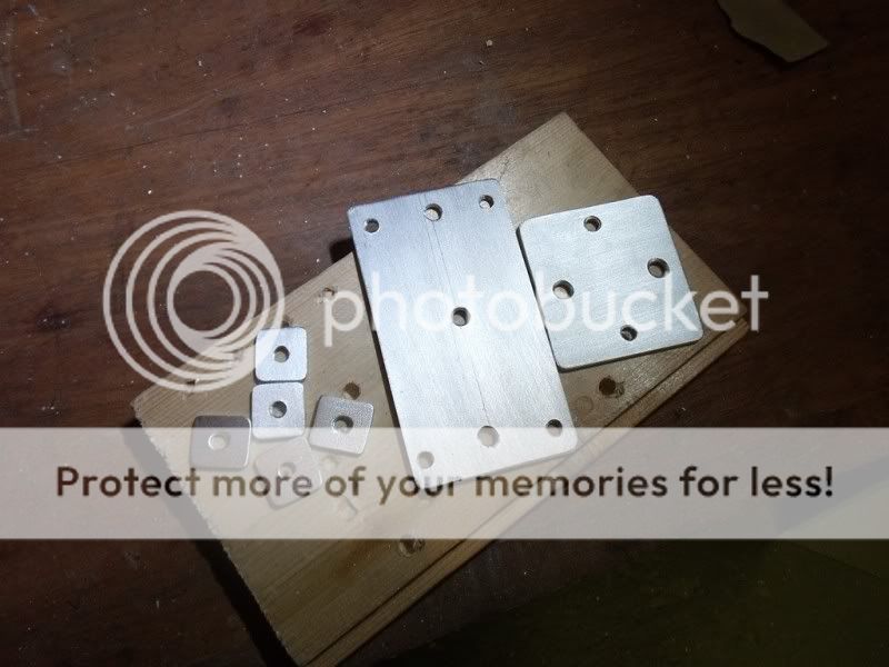

So I made a plate that the QR part could bolt to, and some small sliders for the grooves in the roof bars from some 2mm ali I had in the garage
Make sure they work, they do, so make another plate for the rear wheel carrier.

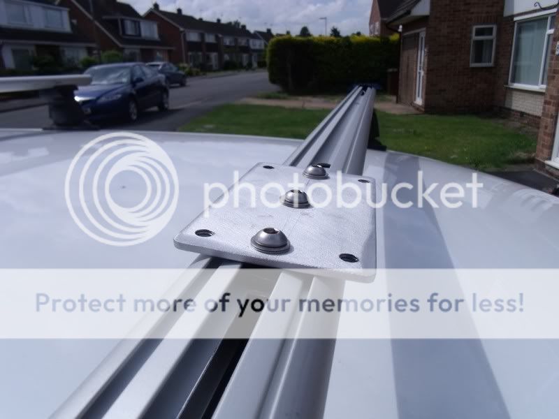

Fitting the front plate to the bar

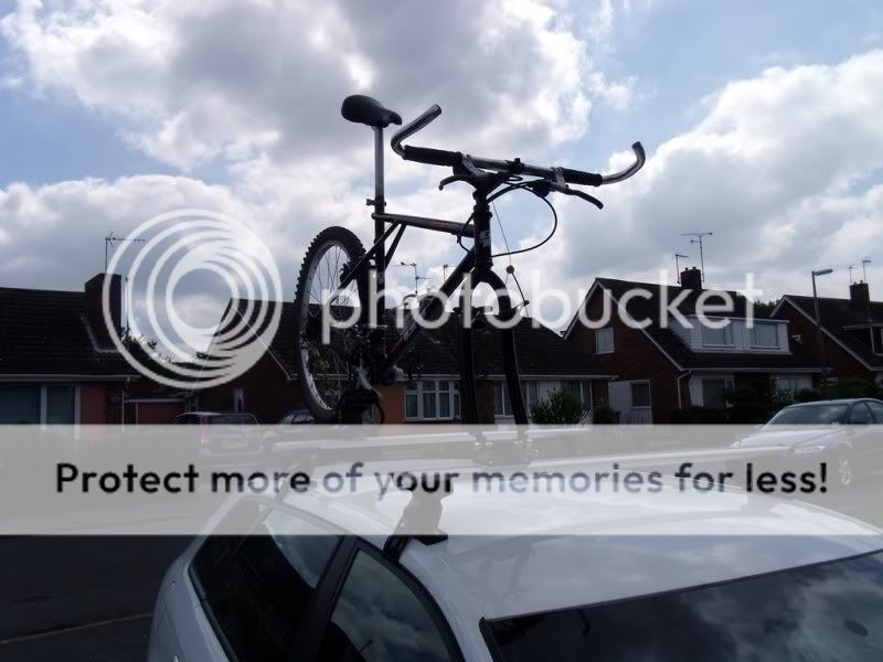

Looks like it's gonna work, so mount everything up and hey presto, a working bike rack.
Now I know it works and holds the bike securely, I may well remake the plates with a bit more finesse.
