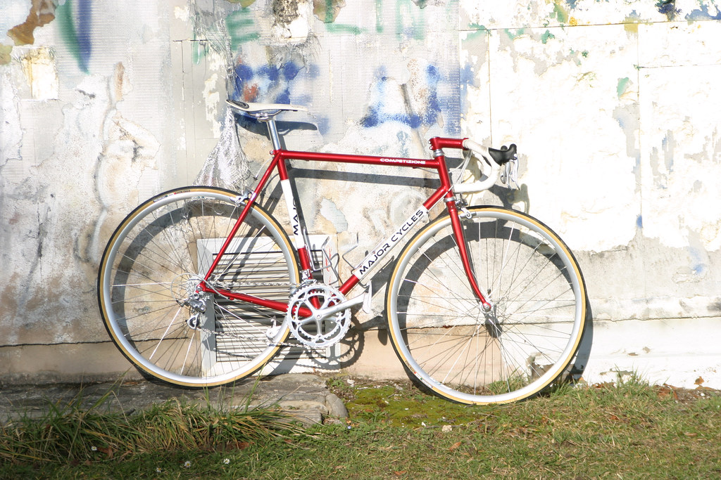

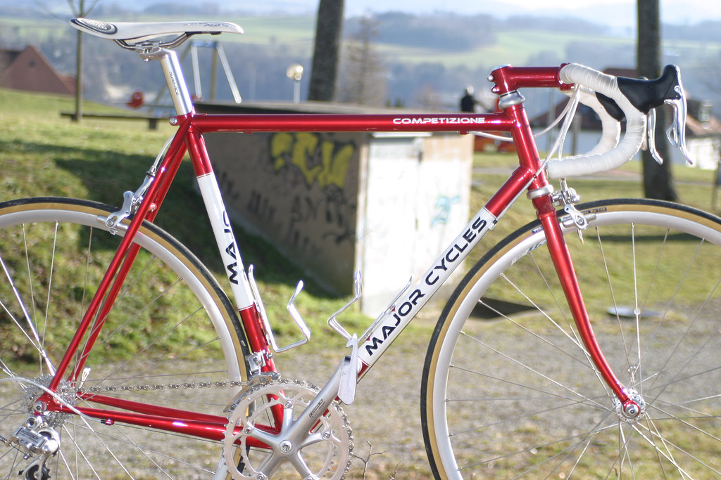

This Thread is about my Major Cycles Competizione. Handmade steel frame from Columbus 0.8 - 0.5 - 0.8 tubing. Geometry is designed to my needs (and whishes) with a short wheelbase...
Yes, Wheelbase is really narrow :lol:

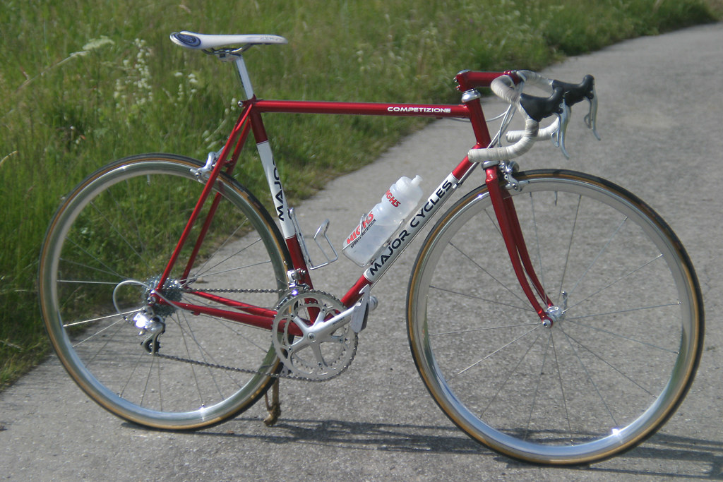

The intention of this geometry was to have a ride similar to common Track bikes, but with a rather deep bottom bracket. So it is stable when running freehanded straight on - but it turns into every corner as soon as I think about. This is, what it really does, so everything is fine about the geometry idea... Especially it does not at all lock into a turning radius but can also be angulated more or less during cornering.
Furtehrmore I just love the look of an ultra-short rear.

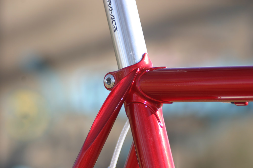

Well, it's not a "homemade" frame. It's the result of a frambuilding class almost three years ago. But anyways, every braze and every bit of filing was done by myself.
Tom
