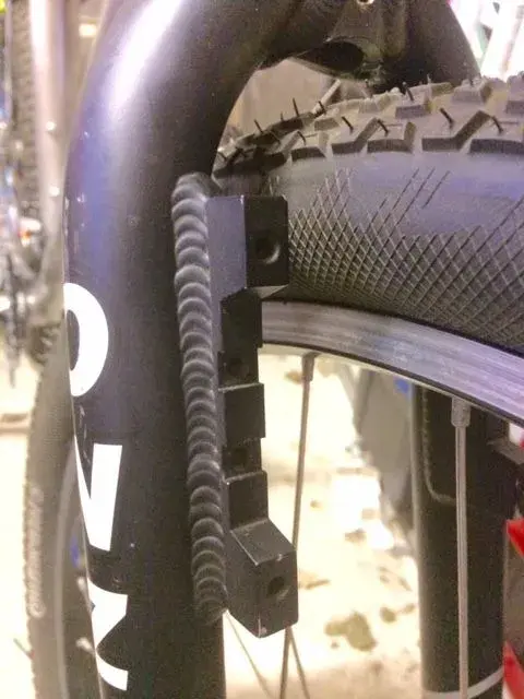

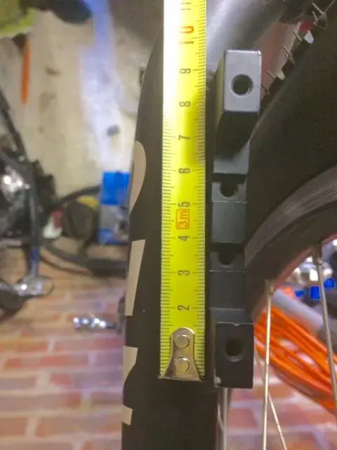

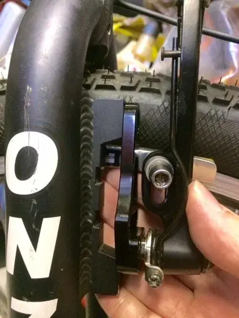

Hi All,
I'm building up a '94 Cannondale frame and fitted some Onza alloy forks that have Margura fittings.
I got some adapters off eBay but they seem to small... am I missing something stupid?
Cheers,
Gary.
Here are some pictures:

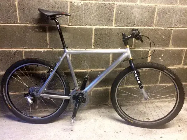

And for those interested, this is the build so far.
It's doesn't weigh a whole lot!

So any idea on the adapter size?
The back of the frame has normal brake bosses, so either way something has to give :-)
Can fit later Maguras on the rear with Magura EVO2 mounts (just a simple bracket which fits on the rear canti bosses).
An engineering workshop or some careful hand fettling at home and you can likely get the V working up front.
Damn it.
Just realised, the Magura's HS11's still won't fit as the brazed on mounts are to low...
Any ideas anyone?
Your fork is intended to work with either a 26" or a 24" wheel, so a Magura brake would mount to two of the four bosses on each side using adapter blocks like the ones in this auction:
http://www.ebay.co.uk/itm/351273418144
