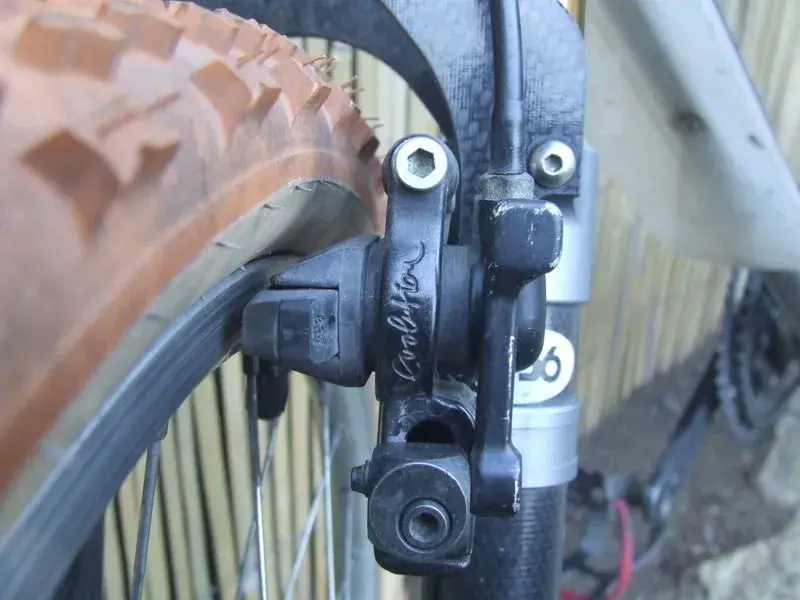

£45-50 will get you a set, I've bought two sets off here and one on eBay and all they have needed is bleeding. Like someone else said, the HS33's have a slightly bigger cylinder which means more oil/more pressure = harder stopping.
I've got some HS22's that have been on my Pace for 12 years and on my Saracen for 4 years before that, all I've ever done is fit new pads. Grey pads are best all round, Green Frog for wet mud and red ones for better stopping power (but they wear fast).
Ancient HS22's >>>>> :D

I don't think that the later HS33 (Evo2) brakes are any more powerful than the original "Evolution" ones - they both use the same slave cylinders anyway.
I personally prefer the early levers ( the adjusters are easy to use with gloves on too) and second the advice about using the red pads for slow technical type riding. Much better than the standard black compound (especially in the wet) in my experience.
