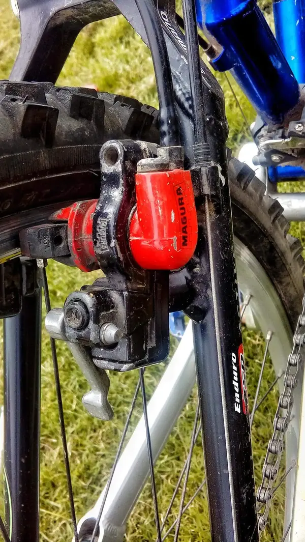

Magura rim brake help
Will get a picture tomorrow because barely been home today. Best way to describe it is the black clamp that goes around the caliper/piston bit :lol:. The bottom of the clamp is the quick release lever bit and the top bit is where the booster boltson to. Thats the bolt thats missing.
This is the missing bolt. Holds the booster and clamp
Cheers guys. A seller on ebay is sending me one now. Thats literally all I have to fix now and the fsr is ready for action. Only been a month or so but feels like an eternity. :lol:. Just nice to get a bike for me built up because been too busy building bikes for other people lately.
