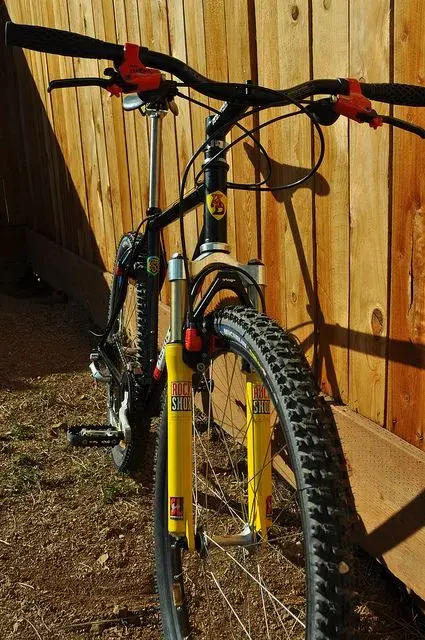

Magura's can be mounted to forks with Canti or V brakes no problem, both Gerard and Regan had them mounted on their Mayhem rides.

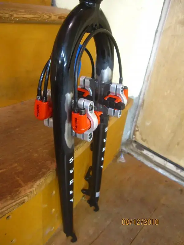

there are different mounts for trial bikes as seen below that bolt on, everything else uses canti mounts so you should be fine.

I've had a 'few' sets of maguras, and have only found one set of canti/v brake mounts that gave me problems (they were an unusually wide spacing on a set of seatstays)
Assuming yours are bolted to canti/v mounts, they'll bolt up fine after a bit of adjustment.
The only time they wouldn't was if they were the 'Firmtech' model. they're attached in a totally different way that looks nothing like a canti post, and were the only real change to the magura slave cylinders for years. Prettymuch only found on magura/rond forks i believe?
Not quite, the early pace system is the same twin bolt design still used on trials bikes that uses standard slave cylinders.
The Firmtech looks like this;
