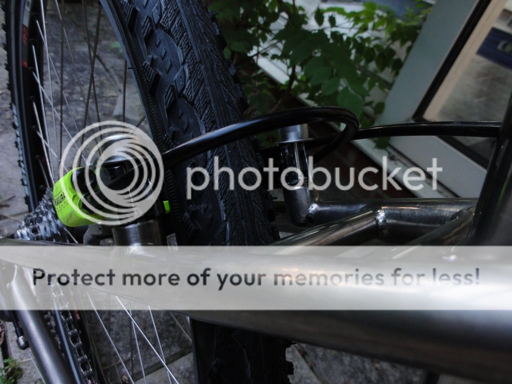

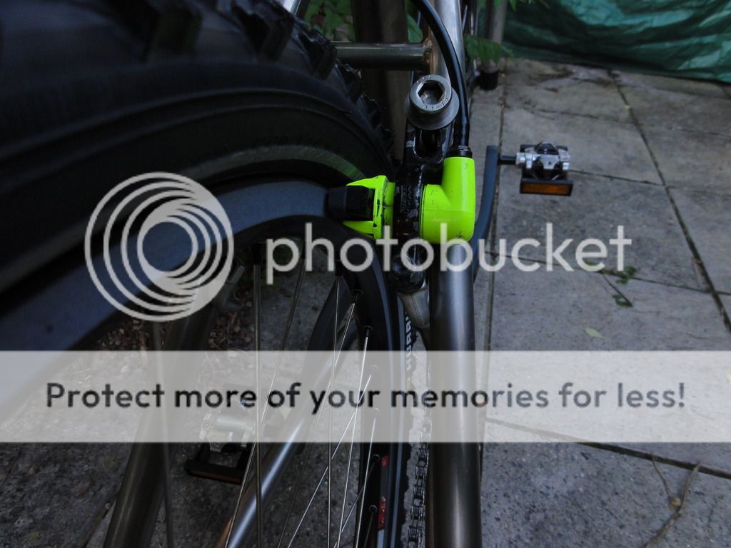

So, how easy is it to make the maguras fit on the U-brake bosses? I assume it can be done, if you've done it on the Xizang :)

I've completely removed the original U-brake bosses, modified the magura mounts significantly, customised some bolts and washers so that the magura mounts are sandwiched between as much material as possible. The U-brake bosses are much further from the rim than canti bosses.
Whilst investigating I saw a U to V conversion plate which is a safer solution, but mine have held up enough for me not to think about them.
