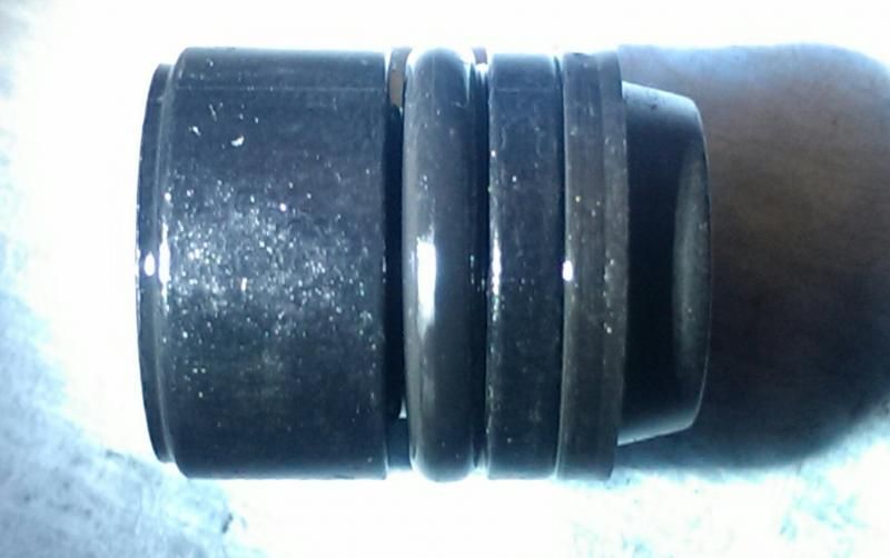

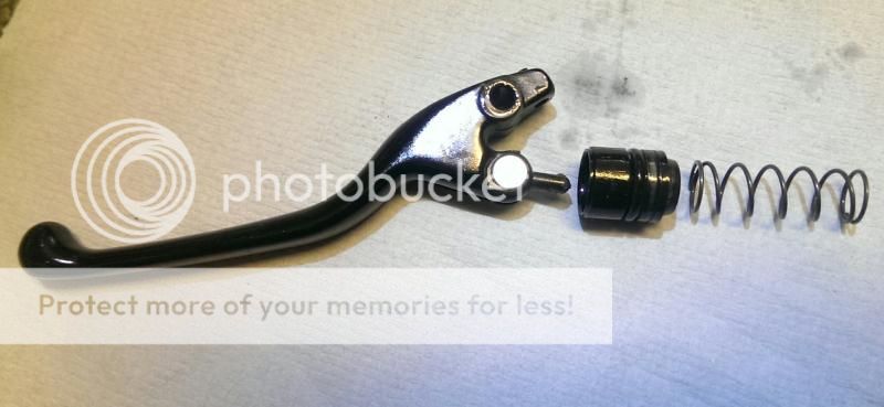

I took a few pics, may be of use to someone in the future. These are what I believe to be HS22 Raceline brakes, early 90's.
Master cylinder piston and spring.... notice what's missing? :roll:
Parts lined up...

Close up of master cylinder piston showing O-ring seal...

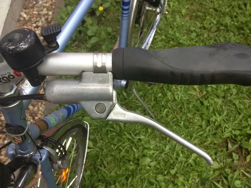

Is there anyone who can teach me about the serie of my Magura with the information of the Image?
I'm not sure and I need a new Brakelever for the right.
Thank You Very Much!!

You have the very earliest magura Hydrostops. late 80s, early 90s.
ANY magura rim brake lever will work for you. Nice caliper mount too!

So do you think it's possible to connect a new rim brake lever to the old rear brake?
Because the Brakes are working, I only need a new rim brake lever (for the right) and a new tube.
Or is there any chance to get the old lever from the late 80s/early 90s in the internet?
They are essentially all the same, so a more modern lever should work fine. I'm sure that the early levers come up occasionally on ebay, but they are unusual with that lever.
