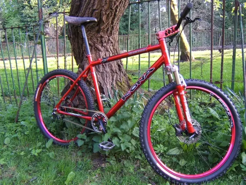

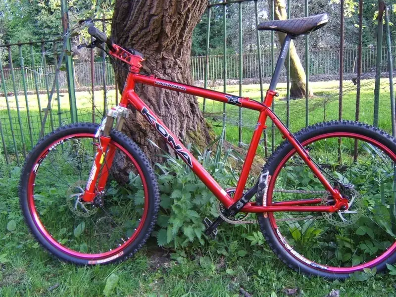

My red&black single speed
My first foray into such things,and i think ive pulled it off :D
Post and saddle will be changed to a black kona post and a red and black DMR saddle along with a pair of red X-lite skewers.
All of which in enroute :D
37x16T set up is fine so far for everywhere ive been.
the chainline is a little off due to not having a provision to run the ring on the inside of the crank spider,it means the cog could come over a little bit,but to do this i need to get the SS multi spacers,im using the gusset twin spacer the fat curved ones.with that ive only got the choice of 2 cog positions.
It hasnt thrown the chain yet so it seems to be a minor niggle,i can fettle it at a later date.
Maybe need a fork service,the crud on the left stanchion is from minor dry use,could be a problem showing up.At least with the bombers thats not too difficult a job.
