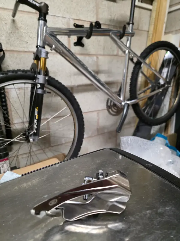

Interesting, initially I had a bit of trouble with alignment but got there in the end. Not been ridden in anger yet though. Will keep an eye on it.
