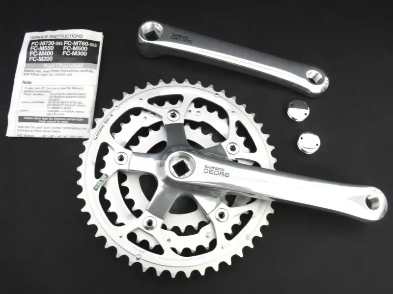

Its very short lived.
There are two types as mentioned, stamped and pinned and the machined and pinned. Long term use found the stamped rings a little soft whereas the XT/ XTR machined rings are much tougher.
My own XT equipped bike was built in April 1993 and had the none pinned SG rings. DX and the 'new' low pro LX chainsets had stamped SG-X rings but then the whole 110 BCD was rapidly replaced by the 94bcd groupsets..
It is very common to find XTR chainsets with the stamped rings being passed off as XTR although not always maliciously
Front and back annodised XTR SG-X rings
LX rings
DX Rings
XT Rings
