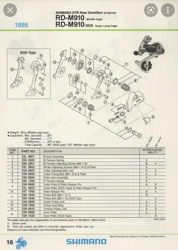

Hi all, I’m hopeful someone will have the knowledge I need.
Does anyone know of a long cage rear mech that has the same cage securing arrangement as an m900/m910. That’s the one with the removable stop in the cage plate and then the 5mm Allen bolt that holds the cage plate to the mech. Hope I’ve managed to explain that ok?
Thanks in advance for any help. J
The schematic says it’s interchangeable with the M737.
Type B means it looks different but fits.
Hope this helps
Matt

Thanks for that Matt, I’ll look into it, pretty sure I’ve got an m737 lying around somewhere.
