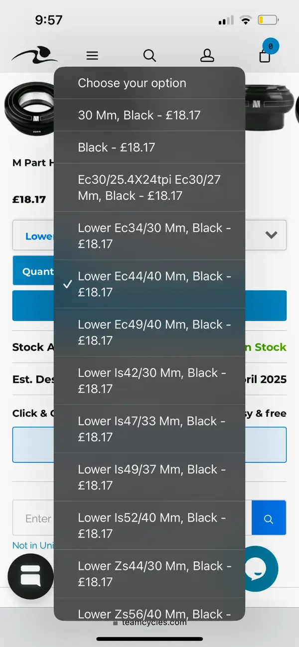

shepp Retro Guru Apr 22, 2025 #1 Hi Looking to buy a M Part headset and it seems a lot in variety of sizes. Anyone able to help explain what I need to order. Have a 1 1/8th head tube and 2001 rockshox sids. Thanks Dan Attachments IMG_3933.webp 64.4 KB · Views: 3

ishaw Gold Trader GT Fan Feedback View Apr 22, 2025 #2 If it's a standard 1 1/8 head tube, you'll be wanting an ec34 top and bottom. Ec = external cup and 34 is the diameter in mm.

shepp Retro Guru Apr 23, 2025 #3 ishaw said: If it's a standard 1 1/8 head tube, you'll be wanting an ec34 top and bottom. Ec = external cup and 34 is the diameter in mm. Click to expand... Great thanks
