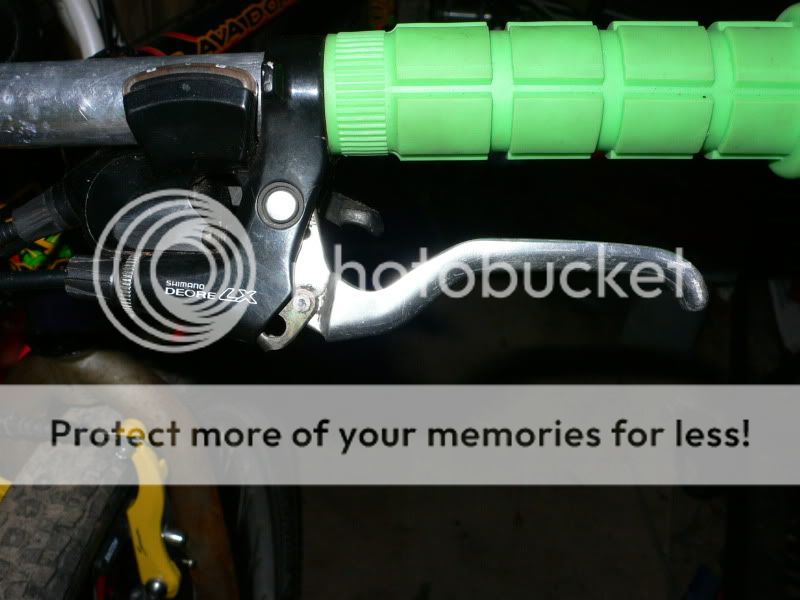

So what exactly is this then?
It's Deore LX, it says M563 (from '94 apparently?) underneath and it's a V-brake lever yes?
Or am I missing something here?
