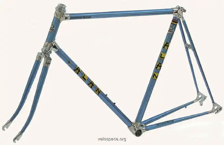

Did the bike look like the one in the picture? If so, it's probably a 'screwed and glued' construction - the tubes are screwed into the lugs and held in place with glue, basically.
It was an early way of building aluminium frames, but I think it was also done with carbon frames.
Main manufacturers who did this were ALAN, Guerciotti and Vitus, maybe some others.
Advantages were lightness, and the fact the lugs polish up very nice. Disadvantages were (according to some) that the lugs could work loose after a time.

Thanks for the reply. I was aware of these alan frames and have seen a few of this type before. The bike I saw had the main tubes stretched over the lugs instead of entering them, so still different from these.
