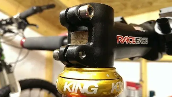

been suggested to try a low-stack headset in order to regain the 20mm i've lost with a new frame that has a 20mm longer headtube! want to keep my forks so looking for other options! maybe a low height stem too with a single bolt rather than two?!

King headsets are 31.4 total stack according to their website.
The M-Part inline is 24mm stack so you get 7.4mm
Might get a 21mm Crap Brothers headset too so that's 10mm
FSA and sure others made/make a 30mm stem which is probably another 10mm over a normal 40mm one.
