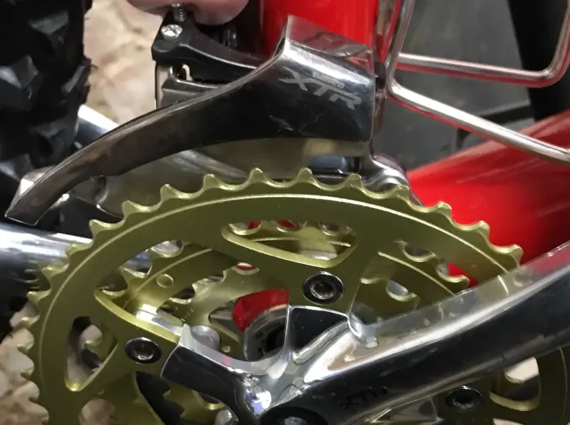

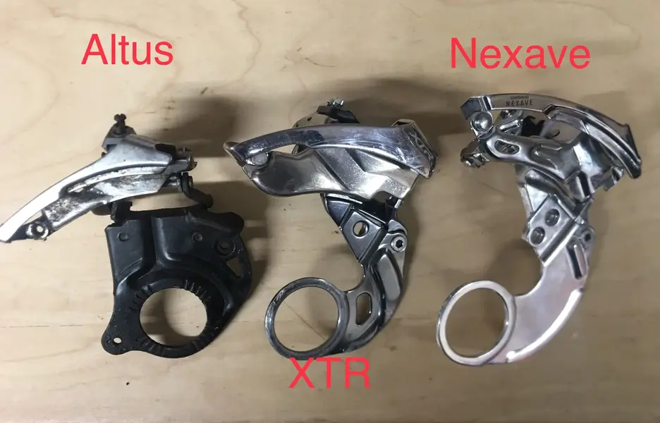

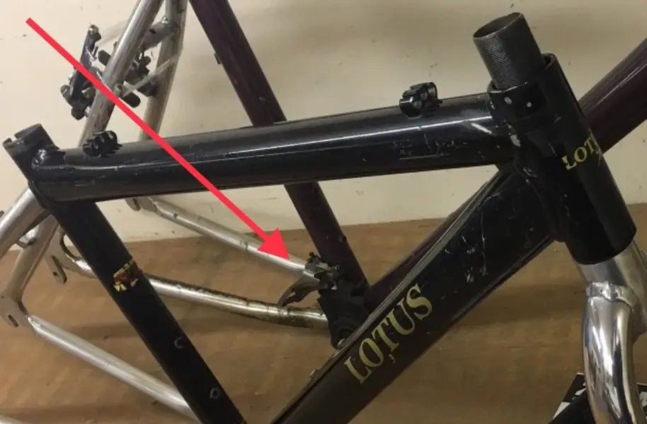

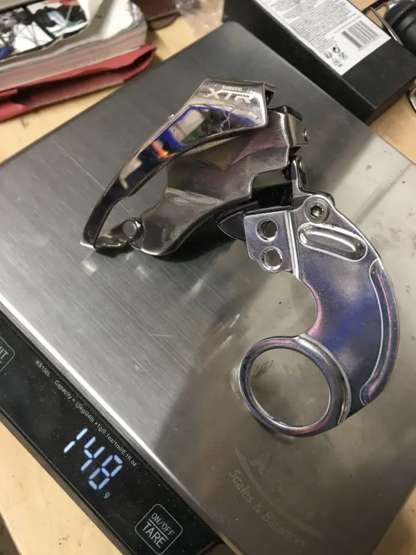

Ok, so while I wait for the rear mech to turn up it’s time I put into practice what I’ve learnt regarding the front mech issues I had on the Campy.
So back on the shelf goes the M900 clamp on front mech and out with my collection of B.B. mounted kit from the odds & sods box.
This frame arrived in my hands sporting a Shimano Altus FD-CT91 from September 1995, weighing in at 244g but this must have been matched with a very small “big ring” as it’s reach/radius from the B.B. is quite small.
The idea was to use a Shimano XTR FD-M960 I had planned for another project, I don’t mind that it’s from November 2004 as this isn’t a Catalogue build & at 142g it’s nice and light, but although it’s taller/larger? It still doesn’t clear the chainset I have... what to do? Well I spied a Shimano Nexave unit with what looked like almost exactly the same style of bracket, just a little taller. Well it fits perfectly and only added 6g....
Job done. 8)
