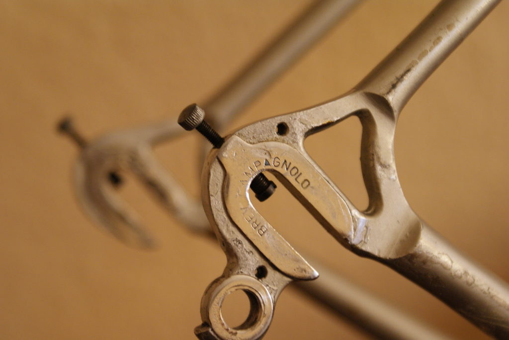

Yesterday I had the HS installed on the frame and gt 1x1 fork no issues except that it's original ritchey cable stop doesn't come out far enough and rests on the top HS cup so that it sits enevenly. Have a silver Paul's funky munkey to remedy this.
After that I tried to install the un 7x cartridge BB that a monkey could install? Yeah right I failed that... Seems the outer threads on the bb shell are well worn down so when I tried to screw the non drive side cup in the threads did not mesh right away and I got scared that I'd strip the threads so I stopped. Going to try a cup and cone model next hopefully the spindle will interfere less with the cup and let me push the cup onto the bb shell's threads easier. Have to be very careful here could be disastrous if I don't :oops:
Will try to get some more photos posted tonight. Soon I'll be asking for help with replacing the forks adjustable dropout adjusters which are badly rusted.

Are the fork adjusters just long m2 bolts with springs under them? Might be able to get some from a diy store that'll work. There's intrincycle on here that I think could machine replica adjusters for you.

You should be able to buy screws like this at your local bike store.
