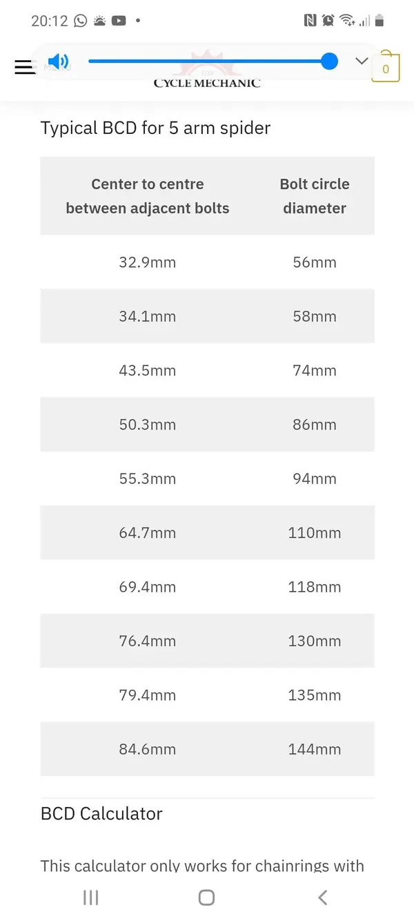

Measured the Mavic Dakar Chainrings at 64.7mm (hole to hole)
This equates to 110 BCD (using this table)
Running my set on Cook Bros cranks. Although not French Themed cranks, the chainrings do fit without any issues.
Cheers.
