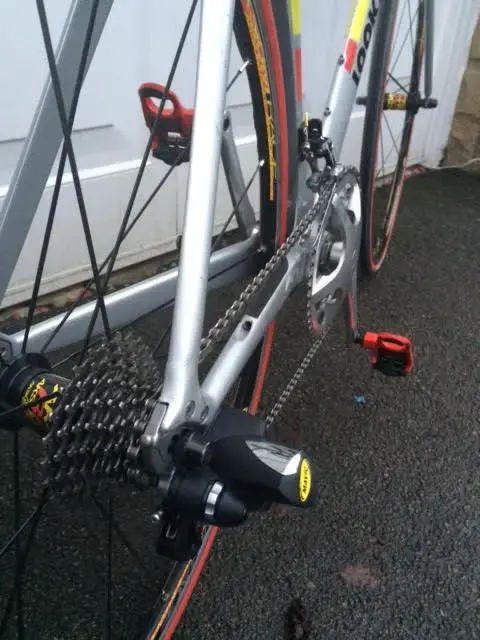

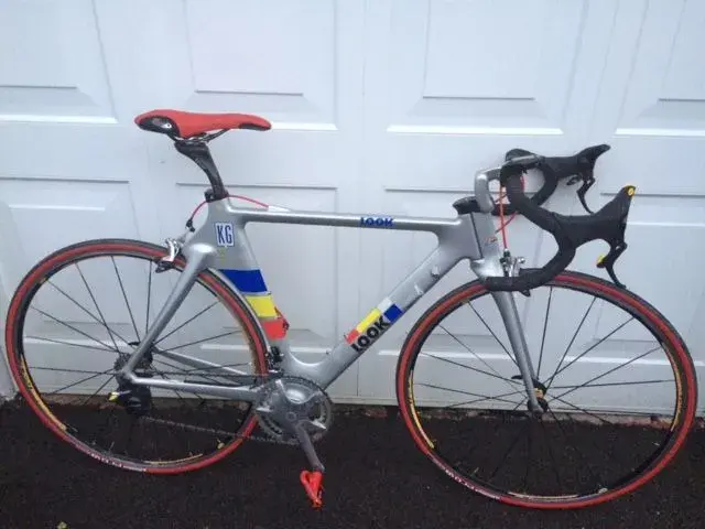

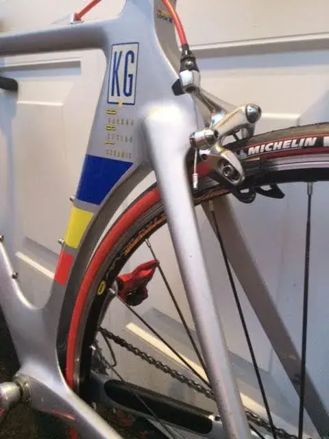

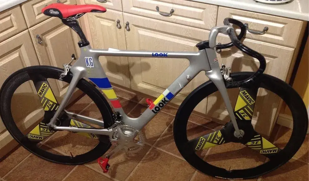

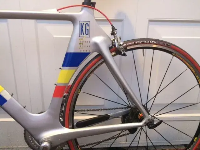

Part built, few issues that held me up. I had to get a new front mech hanger (Giant Trinity) as mine didn't come with one. Needed a bit of modification with a drill and grinder (thanks Will at Wills Wheels) , then the original Mavic SSC front mech didn't fit as the cable pull arm hit the frame, so Ive changed it for campag Veloce for now. I will get the adapter block in time that you can buy from Rotor so I can fit the Mavic one on. He also took out the forks and checked they were sound which they were and realigned the rear hanger. Showing it with the Mavic Aksiums which I'll ride day to day, and my old Mavic 3G's for time trialling on, and no Im not riding it with those sinterised mavic brake blocks I have pair of shoes with yellow carbon pads. Only slight niggle is that is a smidgen too big for me, in the pictures its setup exactly with my measurements. Just waiting for the Mektronic rear mech, computer, and levers then It can be finished....cant wait.

Hi there posted this Pm to BigFish, anyone fell free to help me. The only saving grace is that I have another rear mech, and set of gear levers and computer on their way from another seller...I must be a glutton for it! But god it looks so good without wires...please help me getting it to work.
Darren
And the problems have started with the Mektronic :-( I hope you can help me or clarify some things. Firstly I have a full set of intrusctions and have had no problems understanding them and also have the Mavic troubleshooting guide. Ok I put the rear mech on
Q1. is it ok that you can move the rear mech in and out with your hand?
Q2. Ive paired or at least I think I have. When I slide the computer into the bracket the rear mech makes a series of clicks then nothing. It wont change gear on command. The only movement I've had is from the 12 to the 25, but the computer says its on the 25. I've moved it with my hand back to the 12 and after a while it did go back to the 25 and still read 25 on the computer. I also did a battery check and it cycled through the screens and said the all batteries are ok. Also I dont have the speed sensor yet.
Any help whatsoever would be great. Clearly the rear mech responds by clicking but not moving when the computer is mounted into the bracket. Also I've not mounted the bracket to the bars yet I've had the computer right next to the rear mech for pairing and testing so its not out of range.
Kind regards Darren
