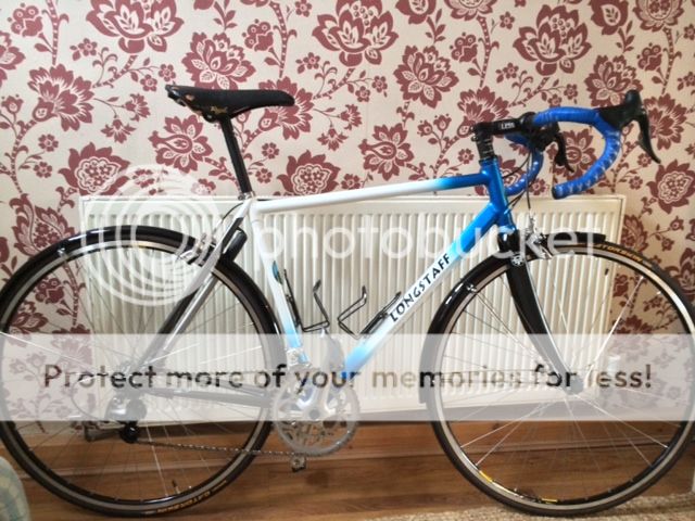

Finally managed to get the bike all finished and ready for the winter rides! Really pleased with how it looks and im looking forward to comparing the ride and feel of the Colubus Zona steel to my 1980's Walvale 531c.
Its built up with a bit of a mixture of campag;
Veloce compact chainset
mirage brake levers / shifters
veloce front mech
mirage rear mech
veloce 9 speed cassette
got some NOS mirage 32 hole hubs from Italy, cheap as well!
Mavic open pro rims
Tektro R359 deep drop brakes
Really looking forward to getting out on it for the Sunday club run. Would be interested to hear from anybody that has one of these, to see what they think. All in all it's prob cost me a total of around £400 to complete (Inc cost of the frame and forks) so i think ive got a bargain.
Here it is anyway
