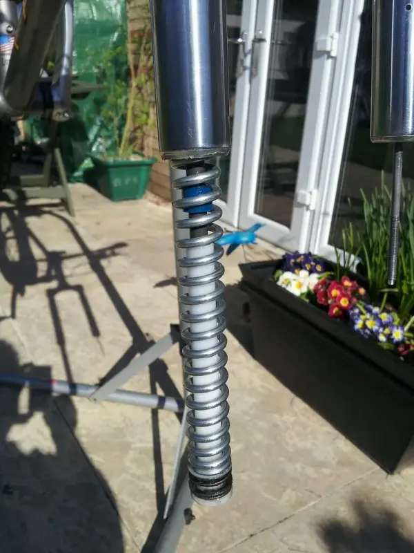

Custom made springs baby! Got some firmer springs made up for the Pace RC36 Evo forks. Cost a pretty penny but they make a world of difference. Will post pics once I have completed the testing and evaluation process.
Here they are, fitted only one spring for now but it appears to be spot on. Original spring is the darker one.

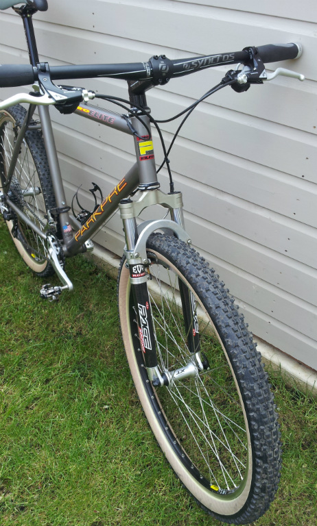

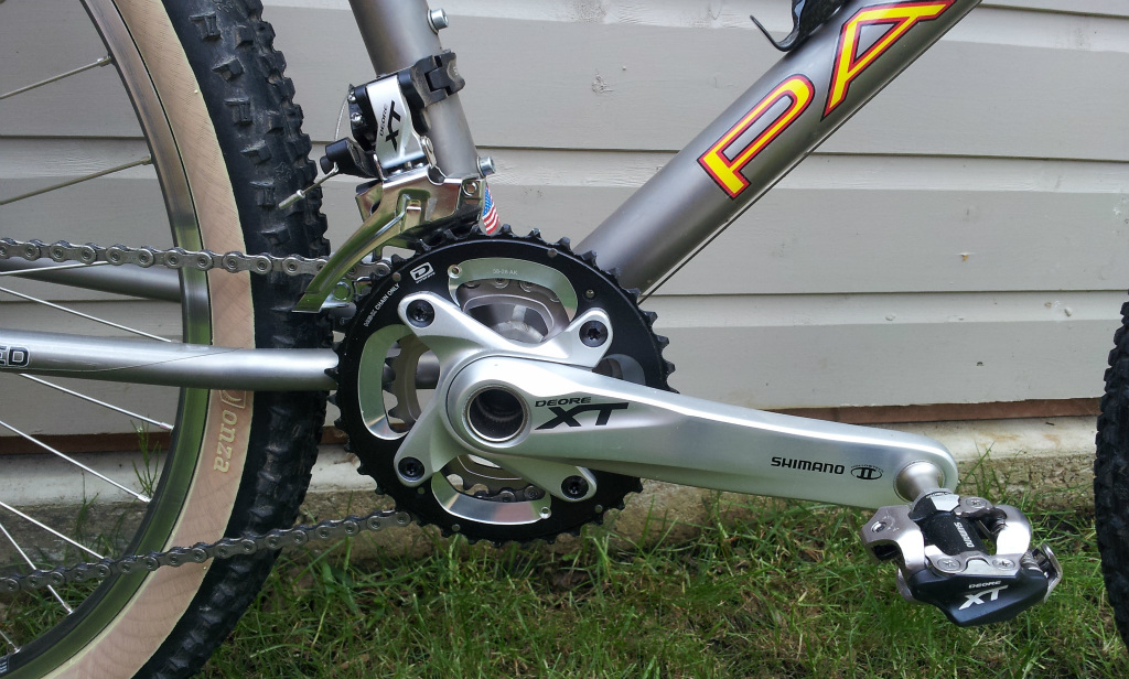

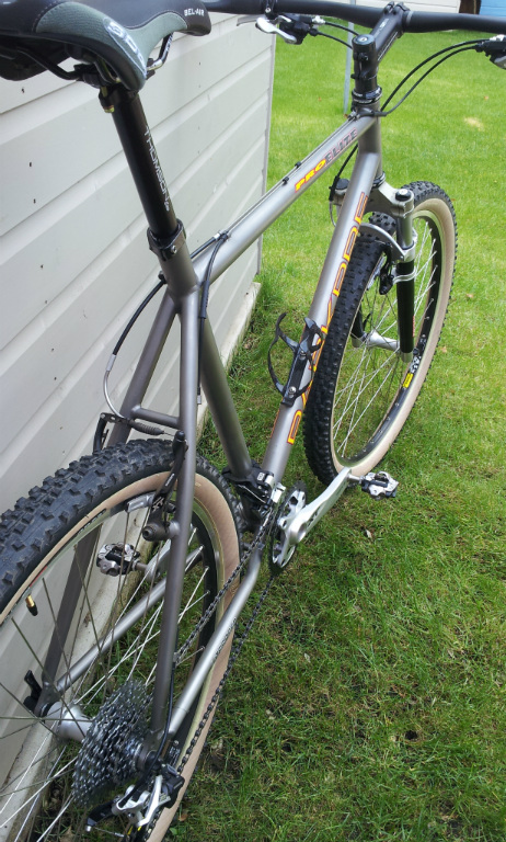

Finally got it finished.
Frame: Parkpre Pro Elite 19" Titanium
Fork: Pace RC36 EVO custom springs
Headset: FSA Orbit MX 1-1/8"
Stem: Syncros FL 1.5 110mm
Handlebar: Syncros FL 1.5
Grips: Ergon GP1
Brakes: Shimano XT M780 v-brake
Brake Pads: Shimano
Brake Cables: Shimano
Brake Levers: Shimano XT M780 I-Spec-B mount
Shifters: Shimano XT M780 - I-Spec-B Mount Rapidfire Shifters
Front Derailleur: Shimano XT M786 - Conventional - Dual Pull
Rear Derailleur: Shimano XT M786 Shadow+ Clutch Rear Mech - Top Normal - Long Cage
Derailleur Cables: Shimano
Cassette: Shimano XT M771 - 10 Speed - 11-36
Chain: Shimano XT HG94 10 speed
Cranks: Shimano XT M785 - 26 / 38 - 175mm
Bottom Bracket: Shimano XTR BB90
Pedals: Shimano XT M780 XC Race SPD
Hub Skewers: Shimano XT
Rims: Mavic X317 36 hole
Hubs: Shimano XT T780
Tyres: Onza Canis 2.25 RC65a with Stan's No-Tubes tubeless system
Saddle: SDG Bel Air Ti-Alloy
Seatpost: Thomson Elite 27.2mm
Welds smoother than a babies bum.
Nice job, I like it. Can't wait to see it on the trails. If I had to be critical I would say the saddle needs to be a flite for aesthetics, but other than that it looks good.
Have you fully tested the new springs?
Those welds are particularly lovely
