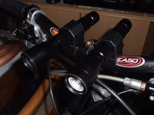

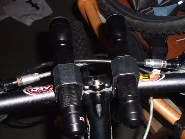

Those 2 Tesco lights I got, I have machined some clamping brackets up at work and hopefully these will be able to be tie wrapped onto my riser bars.
I will post some pics later. :wink:
Got my Tesco lights and a couple of the £5 rubber mounts and they work great for the short commute I do. The beam is sooooo bright, so much better than any maglite I have.
Still amazed at the number of loons that ride with no lights at all, especially seeing as it is now so cheap to get some decent ones.

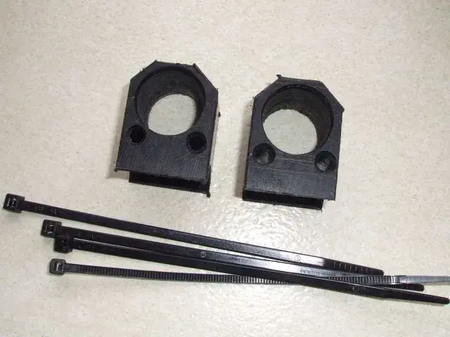

Here are the pics of the brackets I made:- :roll:
Hello Chaps,

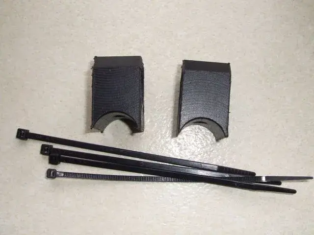

these brackets were made from black nylon. The hole for the torch to go through is 22mm or 7/8", a hole saw was used to cut this. Then a 1" cutter is ran down the bottom of eack bracket to form the radius that sits on the bars. Then two holes are drilled into the blocks for fastening the blocks on with tie wraps. I am quite busy at work at the mo, but if get spme spare time I will see if I can get some made. :wink:
