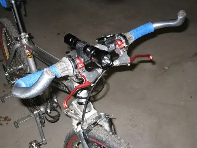

Light 'em up!!!
hey doogie, nice job!
for myself, i couldn't be bothered trying to make my own mounts, especially given cheap mounts available online! :wink:

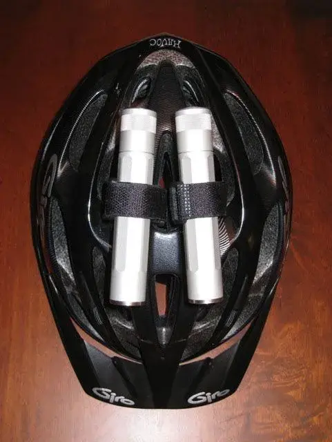

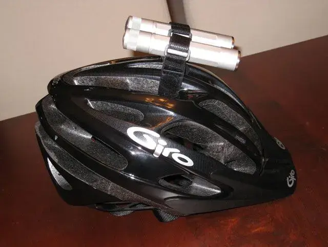

the lights are a set of older LEDs torches i had purchased a while ago and had around the house for emergency. not even close to being bright enough for riding use considering what's on the market now.

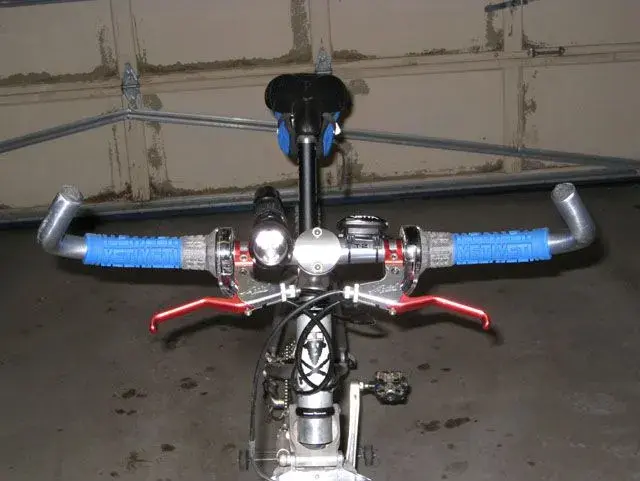

as for the bike itself:

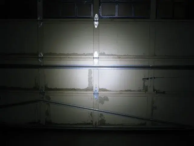

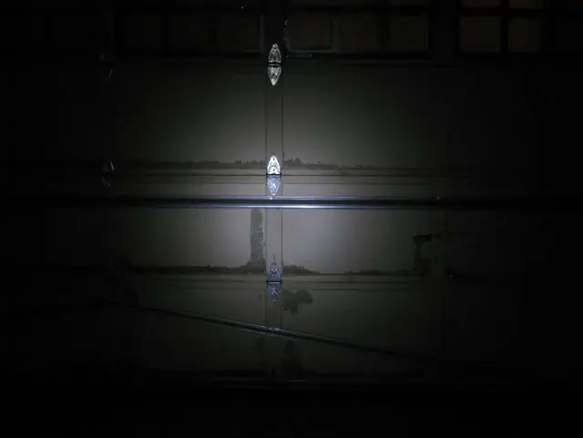

couple of beam shots using the one mounted torch. low beam and high. almost approx 1 car length away from garage door.

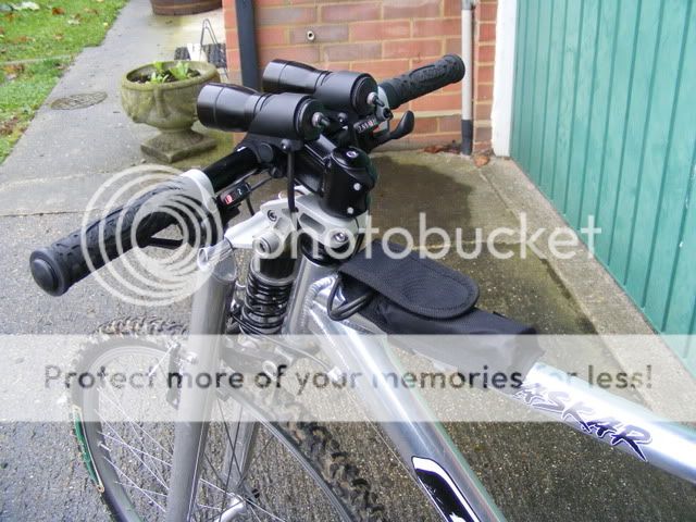

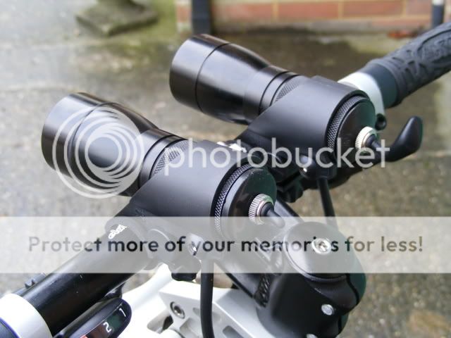

here's my creations
take 2 x tesco C-cell torches, cut bodys down to make smaller/save weight. then get some mounts off the web + 2 x 700mA driver cards.
mount driver cards inside shortend bodys of torches, wire up some waterproof on/off switches, and drive the whole lot from a 7.2v radio-control car battery pack
cost all inwas about £50, combined with a tesc AA 3W mounted on helmet this gives excellent amount of light for cost
cheers - UZ
wow uncle zaskar, that's one fantastic job!
what did you use to cut the flashlight bodies? did you rethread the body for the end cap? (looks like it)
and yes, i 2nd question of where you got the mounts from!

that is brilliant .
if you have time can you put a step by step way of doing this , mainly for wring battery etc...
Yup,
brilliant mate, would you do a step by step please? especially the wiring up :wink:
great value for money and look way-WAY more expensive than the sum of their parts.
take orders man im telling ya :wink:
