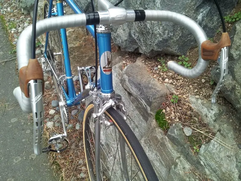

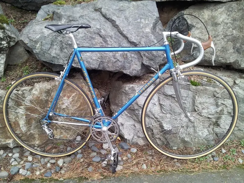

This is a project that I've just finished. I had collected a mix of Campagnolo and Dura Ace components, but no frame for quite a while. And then I picked this frame up locally.
If any Legnano experts could give me more info on the frame's year that would be great. It's late 70's, early 80's for sure.
Frame: Legnano Olimpiade Record Specialissima - NOS, 57cm, Reynolds 531
Headset: NOS Campagnolo Nuovo Record ITA
Stem: Shimano HS-7200, Dura-Ace EX
Handlebar:Shimano HD-7300, Dura-Ace AX
Bar Tape: Benotto Cello
Brake Levers/Brifters:Shimano MA-200, Dura-Ace EX
Brake Calipers: Shimano BR-7200, Dura-Ace EX
Brake Pads: Modolo D-0015 Sinterized
Shifters: Simplex SLJ Retro Friction
Front Derailleur: Campagnolo Nuovo Record '78, rare 4 hole version
Rear Derailleur: Campagnolo Nuovo Record pat '77
Cassette: Shimano FH-7400-6, Dura-Ace (6sp Uni-Glide)
Chain: Sedisport
Cranks: Campagnolo Super Record 170mm '83
Chainrings: 53/42
Bottom Bracket: Omas Big Sliding ITA
Pedals: Dura Ace PD-7400
Rims: Mavic GP4
Hubs: Shimano FH-7260, Dura-Ace EX
Tubes: Vittoria Rally
Saddle: Selle Italia SL
Seatpost: Shimano SP-6400-B 600 Ultegra - Aero 27.2mm
Seatpost Binder: Campagnolo
Weight: 20.7lb

Very nice! I quite dig the colour combination of the frame and the rims/tubulars. Purist might not want to agree on the campagnolo/Shimano combination, but I like it. Did you polished the brake calipers?
Thx. I polished the brake calipers, seatpost and pedals. I may also polish the chainset as there is scuffing to the ends of the cranks.

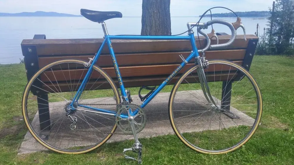

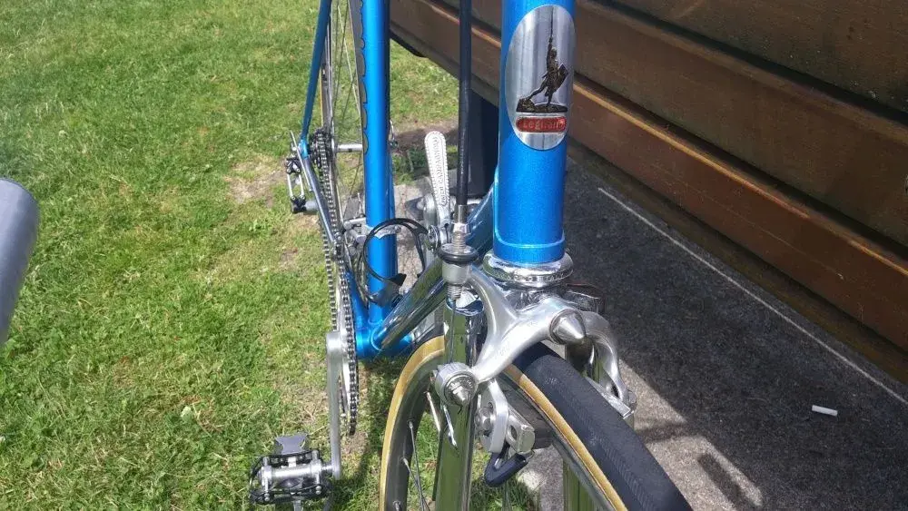

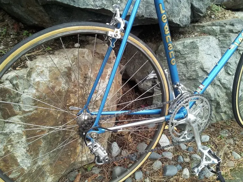

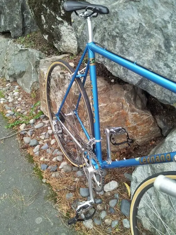

Time for an update on this bike. All of the DA parts were moved onto my '79 RIH.
This Legnano is now fully Campagnolo Record/Super Record with Cinelli bars and stem. Rims are Wolber Aspin Super Champion.

That's definitely one very lovely looking machine.
You have done a great job as it looks very smart with everything coming together nicely.
Jamie
Thanks for the kind words.
The metallic blue of the frame and the gold/brown of the decals and tubs goes together well, so I might look for a suede brown Turbo or Rolls saddle to see how that looks.
Maybe even the gold and black Rolls would suite it?
Either way, it is in its current form a great looking machine, job very well done, enjoy it.
Jamie
