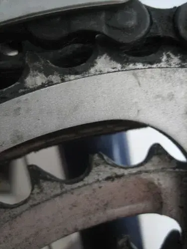

Aaah ok, so is there anyway of knowing for sure? what's the best way to diagnose the problem? Apparently it only happens when you push down hard on the pedals, when trying to move off quickly
Free hub has gone, best buy a new one, I picked up a damaged hub with a good freehub for £5 so just swaped them over took about 10 mins. You could also pick up a new rear wheel in the for sale section.

you would probably want to strip the hubs to check out the bearings and surfaces and the freehub really needs to come off for that anyway.
having said that, are you sure its not just the chain that is slipping? bound to have a worn out cassette and stretched chain if they are original too.

I've think i've just discovered the 'slipping' problem. After a proper, close up inspection of the bike i've noticed the teeth on the crankset are seriously warn.
The teeth have become 'shark fin' shaped instead of triangular, definitely enough for the chain to slip round with force. I guess after 16 years you can expect this type of wear, check out the pics....
