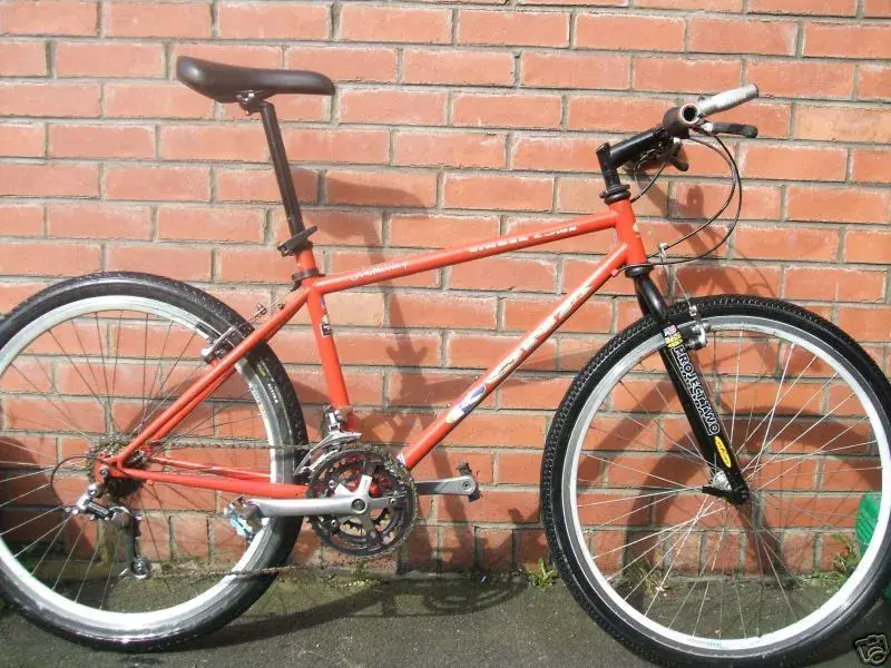

According to the 1992 catalogue, there were three levels of P2 fork that year – P2 Sport on the Hahanna and Fire Mountain, P2 on the Lava Dome and P2 triple-butted on the Cinder Cone and above. The decals look original to me - although they’re not shown in the catalogue, they’re quite similar in style to this 92 Cinder Cone that sold for a mere £131 earlier on today. I guess it’s possible the original owner might have upgraded the forks when he bought the bike.

The forks are indeed triple butted (marked in the steerer cm/tb ) so I guess they were an upgrade, will let you know how I get on with the buffing.
