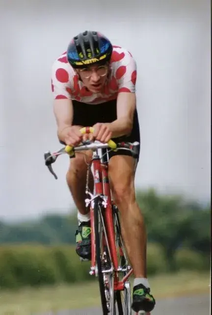

Ha! So you did TTs in a polka dot jersey too? This was taken in the ECCA 10 near Sawston (Cambridge) in the early 90s. Given the location, the jersey is ironic! Actually, I was just too tight/poor to shell out on club kit. Riding a 531 Holdsworth with old Super Record, CX18s with 18mm tubs, DIY sawn-down road drops and yellow Profile tri bars. Saddle is a Selle Bassano Colnago Master Ti. Still using it. Most comfy saddle I've ever had. Replaced the Holdsworth with an old Colnago soon after this pic was taken so it matched better...

Many serious people did by the time my pic was taken. You can see I've taped over the mounting hole to stop it whistling. Remember this is Cambridge, so there wasn't much call for changing gears anyway... It all goes back to money though.
