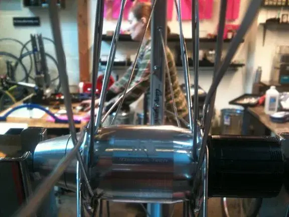

I took a class. It was over a weekend at "Surgar" in Portland.
That's the Prof in the pic. There were only six in the class so you got as much or a little attention as you needed. My retro rims needed a fine tune at the end by the pro to get them just right. Everyone else had a much easier time with their newer hoops. (I refuse to believe that it was my fault of course)
