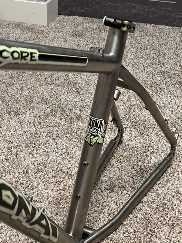

All other Kona scores do have a gusset. Yours is likely THE catalog frame, oddities being no gusset, and a King Kahuna serial, so likely a very early score as even a king kahuna has down tube gussets is addition to top tube..

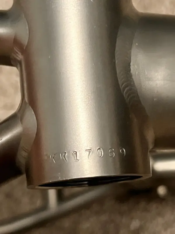

Yeah man, the catalog score and yours are oddly similar and very different from all other Kona Score pics anywhere. No down tube gusset and seat tube water bottle cage bolts are unique to your frame and the catalog pic.
Very cool 😎
Now added:
KK17069 - Original correct Score decals, shorter top tube approx. 21.7" but no gusset and with King Kahuna SN prefix (note no currently recorded 1999/00 King Kahuna with the same SN). Likely early production show, demo or catalogue example.

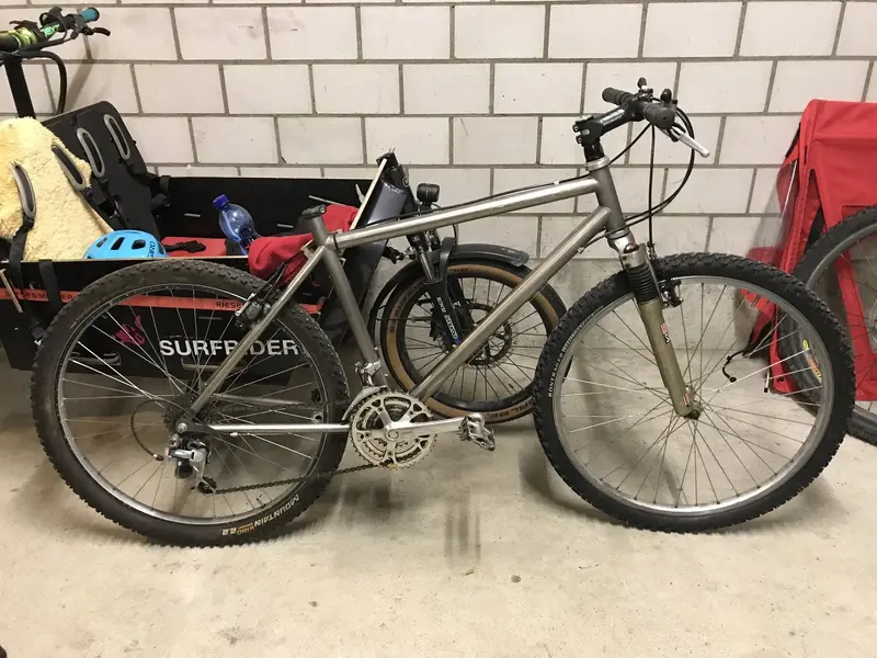

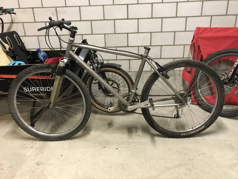

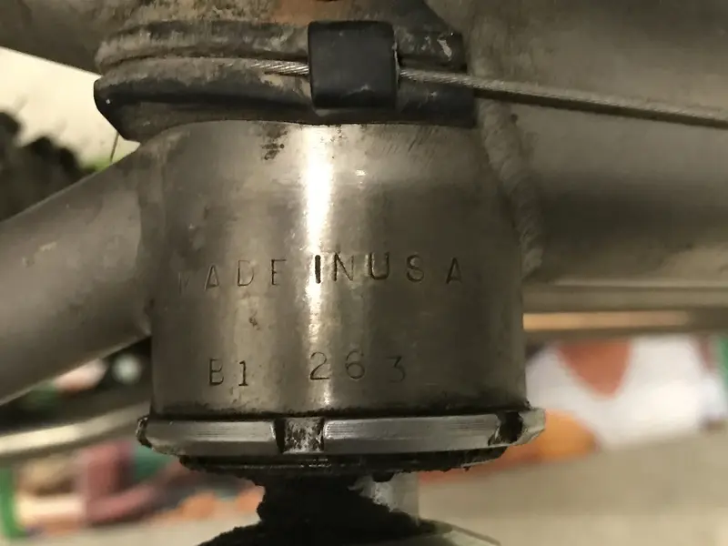

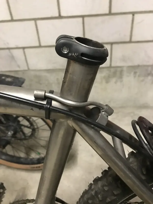

Just procured this lost soul recently. Due to chain drop the third digit of the serial number is almost unreadable. The seller swore the serial number was B19263, but also looks like B18263? What do you all think? Geometry wise, this “looks” like an 18” frame but that super long seat tube throws off my perspective.
Also, 1990? Nah… 1991? 1992? I don’t know :LOL:
Thanks for the help!
BD34B0C6-BD29-4E4F-9019-328E4FE6DB58.jpeg 225A0037-60B8-442F-A5D3-812A4F2EF0EF.jpeg 06F5F426-B7EA-4C82-BBFA-EE1BB4B3788E.jpeg 5219F5EB-5399-4CF3-B0A3-74496848DC0B.jpeg
Thanks for sharing. I'd like the Kona eagle eyed to add their views. From the picture it looks more 8 than 9. Could you go old skool and try a brass rubbing, or something like that to check the marks?
At #263, with solid triangle drop-outs and a complete canti bridge and noodle, it's more 1992 than 1991 as #263 would place it as the earliest 1992 on record so far. The highest 1991 is #081, and the lowest 1992 #281.
Back to 18 or 19, we have no 18"s on file until 1993 which is where I'd love to call on Pip and clarify if 18" was an option between '90 and '92 and whether the lack of them was to do with the measuring format during those years or something else.
To add to this clarity conundrum, we already have B18263 on the list, as a 1994 model, with all the 1994 identifiers! We do know sequential numbers for these frames sometimes over-lapped, but still, it adds to the story.
