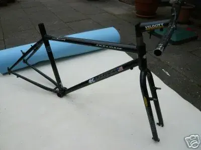

The seller says he has measured from the center of the BB to the top of the seat tube so hopefully he's right when he says 17", From what i can make out the bike has the earlyer 90s decals so im thinking 1991 / 2 ?? i guess i really need the serial # Here is a pic of the bike for sale, what do you think , does it look 17" ??...........I would rearly like it because it goes exactly with my other Kona & i wanted a smaller frame one as well

I'm pretty sure the bike he has for sale is what they called a size 16 and your current one is at least a 19 but could be a 20, can't quite see from that angle. They're both 92 Cinder Cones, although his has the slightly later pattern of P2, still 92 though.

If they are a 16 and a 19, there is 1.25 inches difference in the length of the frame plus another 0.8 in the length of the stem, so you would find them quite different. It may be that a size 18 with a shorter stem might be perfect for you, but if you had both those bikes one thing you could try would be to swap the stems around - that might improve both bikes as far as you're concerned! A size 16 with the longer stem would be pretty much the same length as an 18 with a standard stem.
But of course your positioning over the pedals changes significantly between a 16 and 19, and swapping stems will only compensate for TT length. But if it is 16 and not 18, you shouldn't feel cramped at 5'8".

Well the size 16 did have a one degree steeper seat tube angle Paul, but that only makes a half inch of difference to the saddle position, which surely can easily be cancelled out by putting the saddle further back on the rails, to keep the same position over the pedals.

Can't really tell much from your pics I'm afraid, but I'd guess your bike has a 13cm head tube, whereas Jonnyboy's bike looks to have at least a 15cm (consistent with it being at least a size 19) and the bike for sale is pretty clearly 11cm, which means it's smaller than an 18.
The reason I'm fairly confident that the bike for sale is a 16 is that I've seen several bikes of that size for sale (often believed by the seller to be a 17), but I've never seen one smaller than that. Whereas Kona said their smallest size was a 16 and they didn't do a 17.
