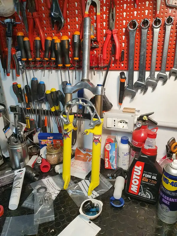

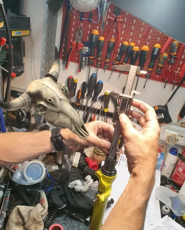

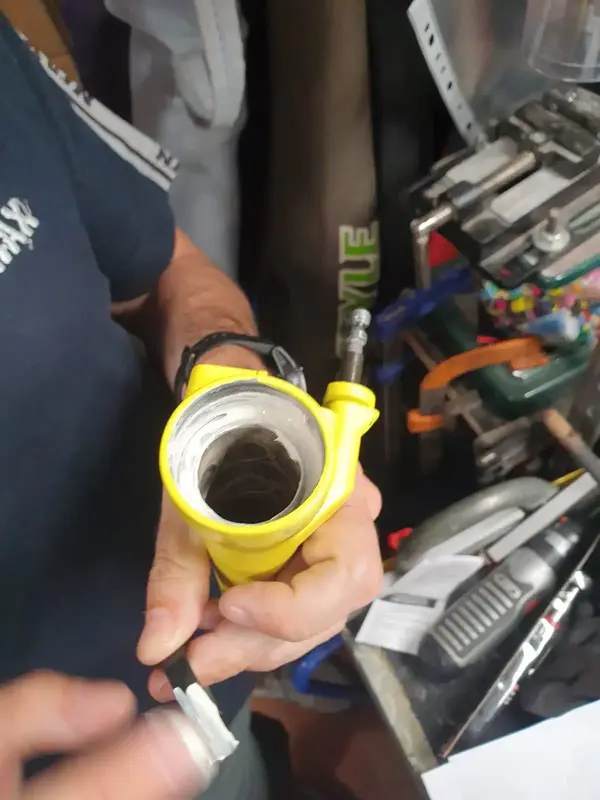

aaaaaaaand finally the front fork is finished! I had some doubts .. but the pdf was fundamental. The fork seems a bit stiff to me but I think it works well. I used 7.5w oil. thanks to dr. Marzocchi for the seals ... I can't wait to reassemble the frame!

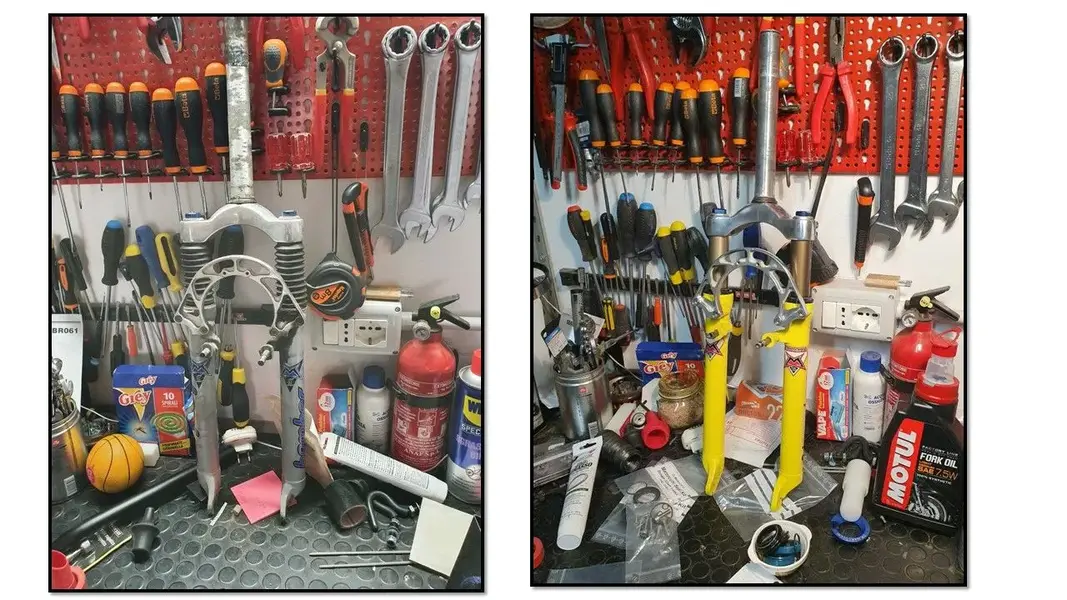

a moment of panic
grease.....

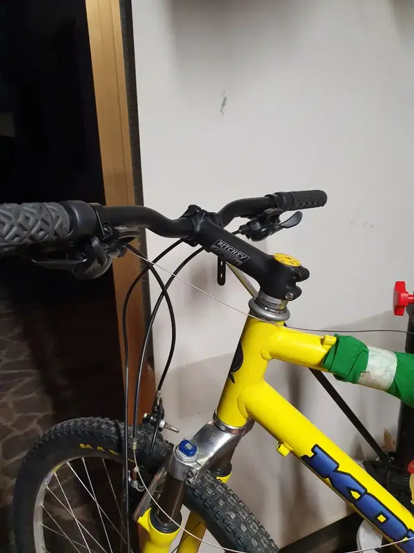

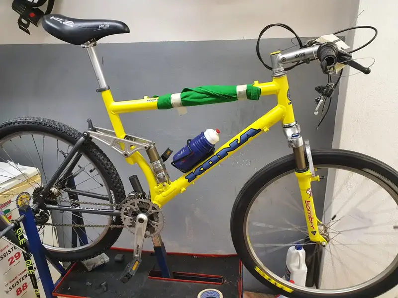

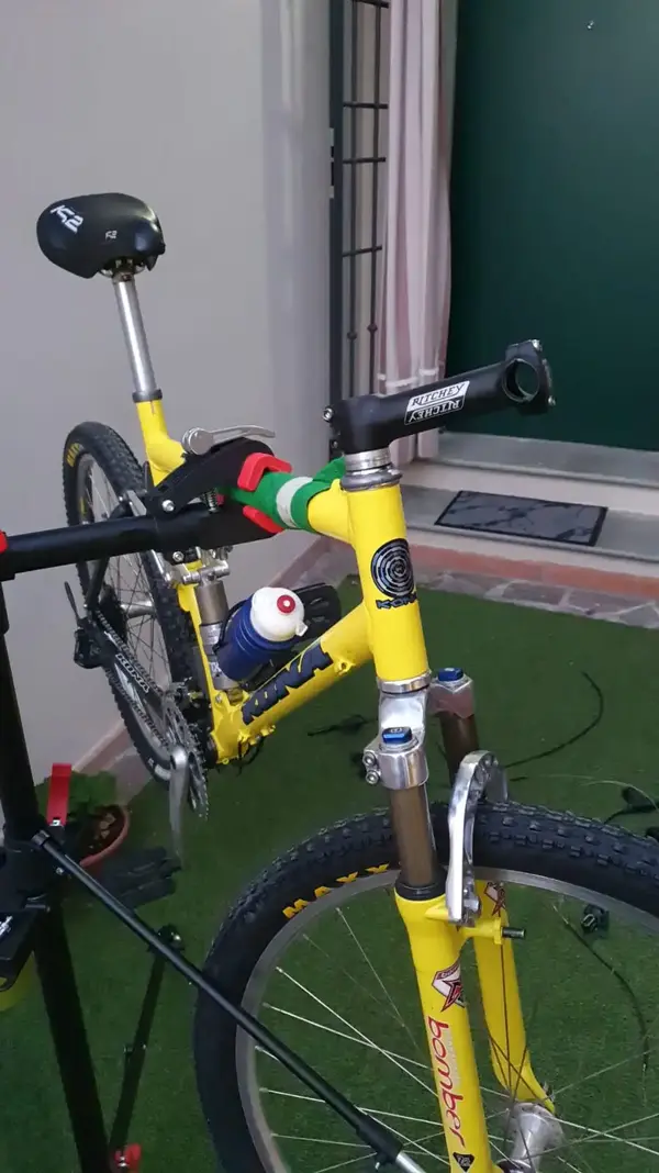

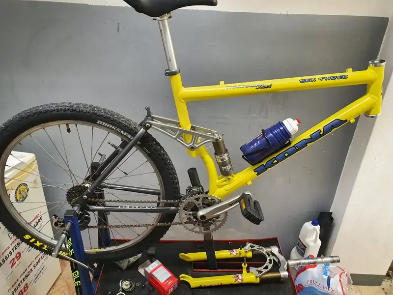

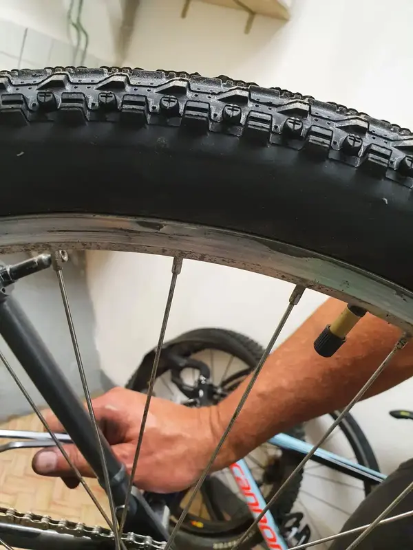

unfortunately the rear rim is broken: can you link me with something used? or the specifications? rim 26 inch, 32 holes .... other features?
