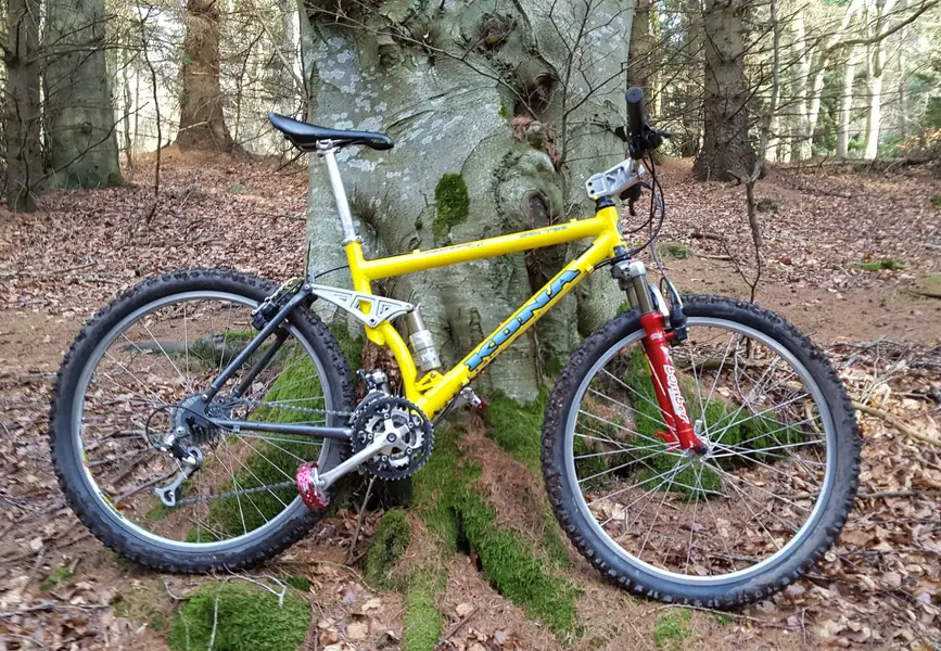

Kona sex too 1997 renovation
Your bike looks in nice condition, bleeding the Magura brakes is pretty easy, just use mineral oil or (Citroen) LHM brake/suspension fluid. You'll need a few basic tools but there are plenty of guides online, all the brakes are the same to bleed eg. HS11/ HS22/ HS33.
Welcome to the Sex Too Experience.... 🙂
The rear shock came with the frame when i bought it . Everything else came for the parts bin :)

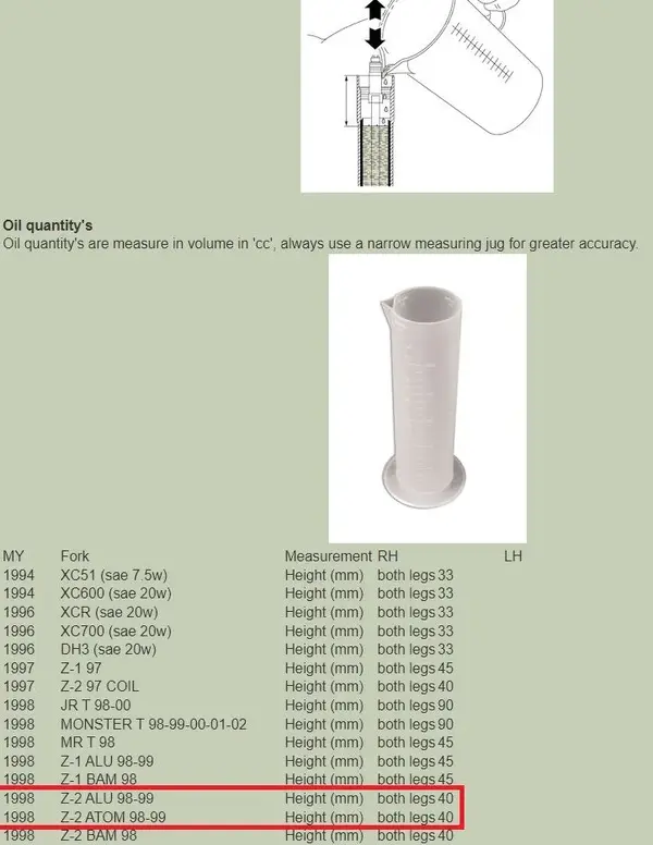

Ps do you know the pressure of the fox alps 4? I felt around 150 psi (around 10 bar)

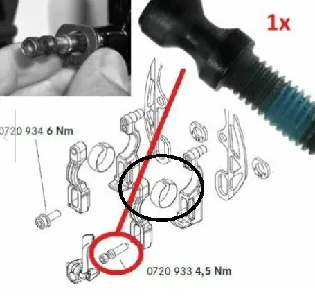

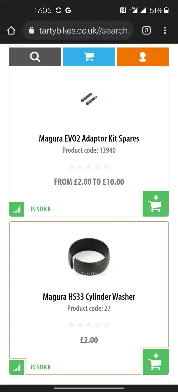

do you know the name for this part ? ( in the black circle)
