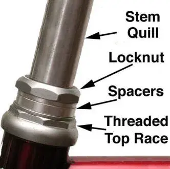

Measure the head tube of your frame. You will need 45-50mm extra on the steerer for the headset if threaded, or 70+mm it using Ahead headsets.
There are low-stack headsets available for borderline cases.
Triple butted forks are stamped CM/TB and single butted forks are stamped CM/SB. The steerer length is also stamped on threaded steerers, further up the column.
The most common lengths seem to be 143, 163 and 183mm.
Weights vary a lot and some SB forks are almost exactly the same weight as TB. It largely depends on the year of manufacture.
The original Kona Impact headset is 32-33mm stack height. A Tange Falcon is the same if you replace the chunky washer with a thinner one. It's a cartridge bearing headset and streets ahead of the original.
