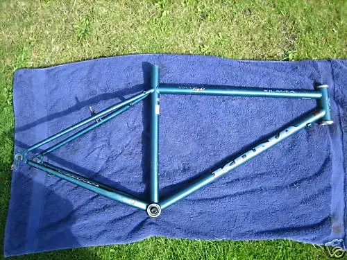

I don't know if you noticed, but the 96 Kilauea frame pictured below sold for £205 on eBay a few days ago. It was apparently in good condition but even so that was an exceptional price - an average condition one would normally go for around £100-125.
