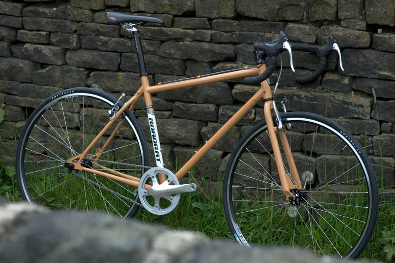

Looking at Ted's bike especially I can't help wondering if Cotic have a 90's Kona doing stud duty for their Road Rats:
..But maybe the Kona is shorter in the chain stays?
I'd be grateful for suggestions about stem length and which components to consider for ***eventual*** replacement - I've read that the BB is one to think about.

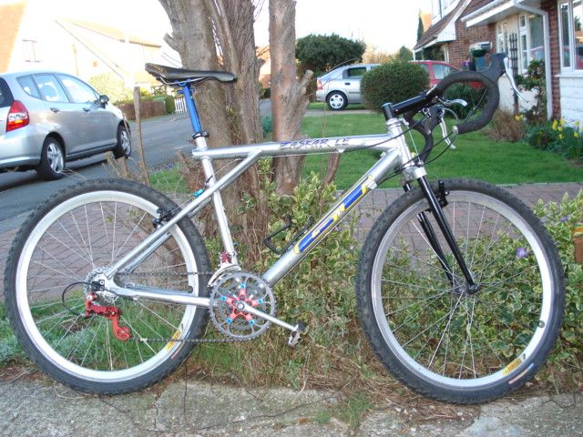

Not sure a CC bike is that limited off road, but I admire restraint your off road approach implies. When I tried my Kona SS with road drops off road my local single track was nigh on impossible (though I could have perhaps put "suicide levers" on if I had canti's rather than V's) so I've now got some WTB Mountain bars on order. But I'm after building a slightly different beast ;)
