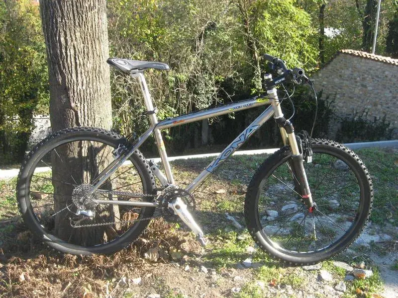

This is the other one I have. Another fairly macho-looking build, which I think suits the powerful personality of the King Kahuna.
Thanks for your riding impressions incidentally. You must be one of the few people on here to be able to swap at will between titanium, scandium, 853 and M2. All you need now is a carbon fibre Kilauea!
Very nice picture Anthony – thank you. It’s curious how titanium frames, or perhaps the KK in particular seem to suit so many various builds including modern components - that is the 2nd picture I’ve seen of a KK with 4 arm XT.
