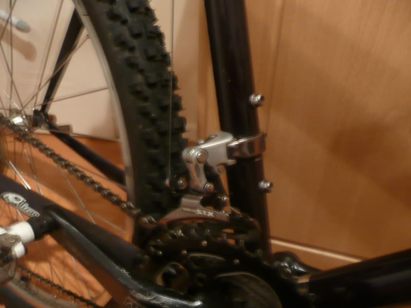

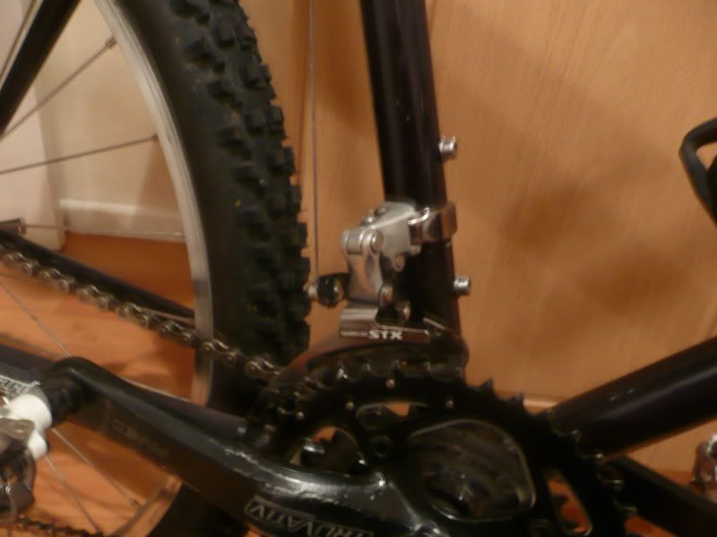

Here are said pics...
What mech is it ??
Cheers
