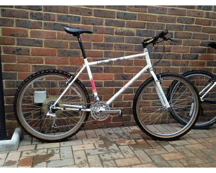

Ok, the garage got cleared, ishaw supplied the pedals & sharkfin (Karma! 8) ) and we have enough bits to build! Note it is built not finished :roll: Still waiting on a decent DX front mech and I think some DX cantis too. I also need to improve my photographic skills.
It rides really, really well. :D Big thanks to the following RB members: Spanky22b, raidan73, Konafan78, scant, ishaw
Frame: 1990 Cinder Cone – Tange DB steel (19 3/8”)
Fork: Kona Project Two (1”)
Headset: XLC aluminium with cartridge bearings
Stem: Kona ICR
Handlebar: Kona 165 alumnium
Grips: Foam
Brakes: STX - to be replaced
Brake Pads: unknown
Cantilever cable hangers: Shimano
Brake Levers: Kona Command
Shifters: Shimano Deore DX thumbshifters
Front Derailleur: Shimano 400LX - to be replaced
Rear Derailleur: Shimano Deore DX
Cassette: Shimano Hyperglide
Chain: KMC z51
Cranks: Shimano 500LX
Crank Bolts: Shimano
Chainrings: Shimano / Tigoa - to be replaced
Chainring bolts: Shimano
Bottom Bracket: Shimano UN51
Pedals: - unbranded
Hub Skewers: Shimano
Rims: Araya RX-7
Hubs: Shimano 500LX
Nipples: ?
Spokes: Galvanised chicken wire
Tyres: Tioga Psycho TT & Muddy Fox
Tubes: unknown
Saddle: Kona
Seatpost: Shimano Deore XT
Seatpost Binder: X-Lite titanium
Weight: quite a lot.

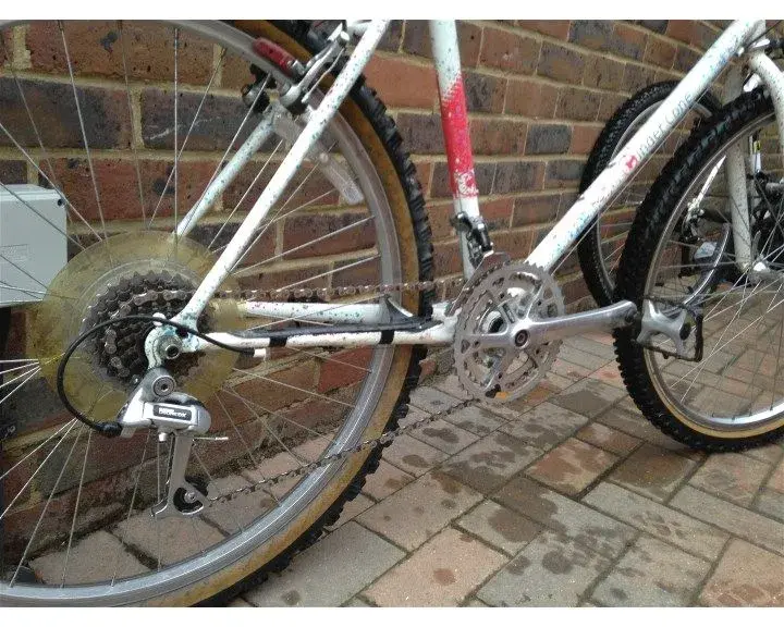

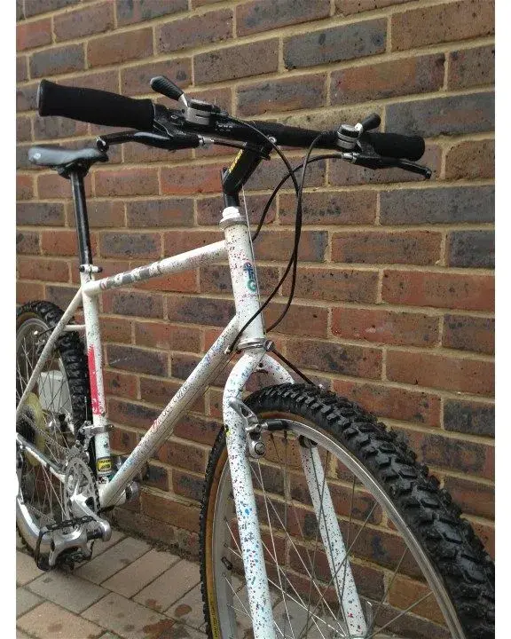

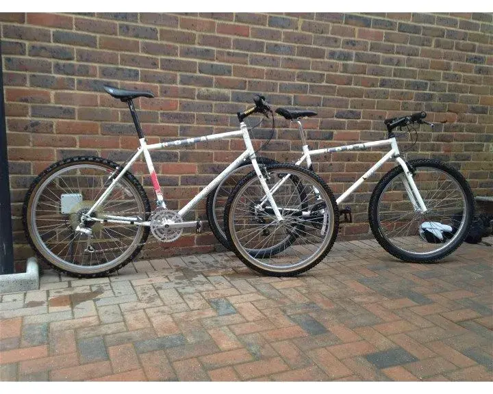

Photographed with its smaller (18") Lava Dome sibling after a ride. I went out with my brother-in-law on Sunday for a post-lunch bimble to work off the roast potatoes :lol:
Either you've done a very good restoration of the rusty bits or your photo's have been taken from strategic angles to hide it but that looks great. From those pics I don't know why you would even consider a repaint.
Hmm, not so much restoration as a cack-handed photographer with shots taken at a distance! I bought a little pot of Humbrol gloss white enamel paint and rubbed back the really bad bits to bare metal and gave it a couple of coats with a brush. I had placed it next to a radiator for a few hours to get nice and warm then painted it and stuck it back there for another 12 hours and then repeated. It was in the living room on a workshop stand which went down well with the family :lol:
It looks bloody massive next to an 18" frame. Bizarrely it is just over 19" centre-top at about 19 3/8". The modern XLC headset is nice although the cups are very thin and need a lot of care to fit:
