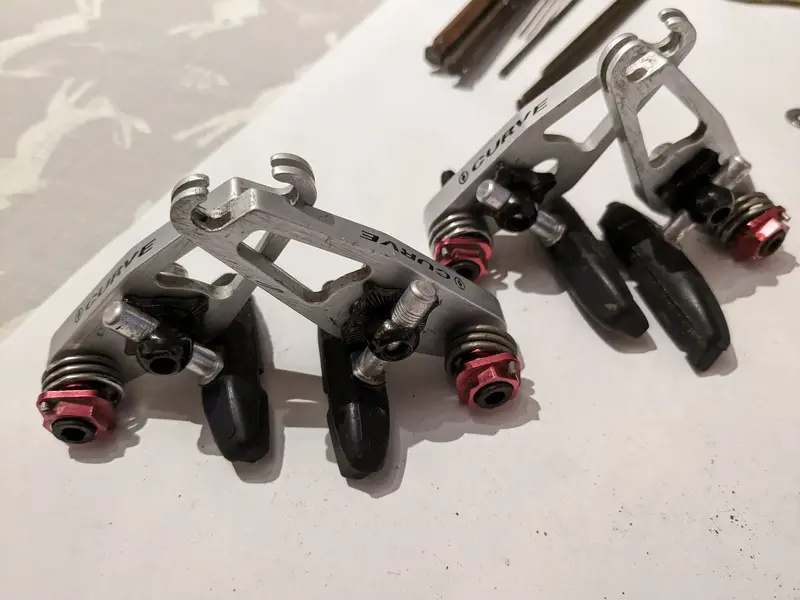

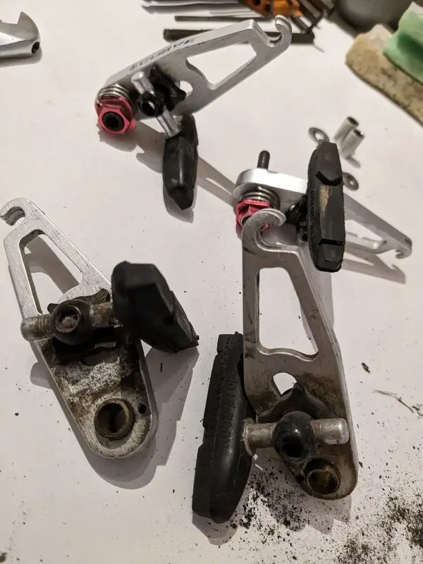

Brakes cleaned up a bit the other night, I can see why they're fiddly, not sure I'm looking forward to setting those up....

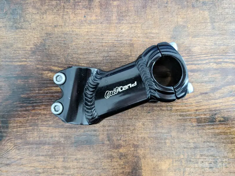

A shorter and slightly higher stem option was also available at a price too good to pass up. I'm hoping the second choice bar will also arrive today to allow for some garage time tonight or over the weekend...

Ref setting up the curve cantis, not too bad really, use a spanner to hold the collar at the right spring tension, and tighten bolt with Allen key. Adjust if needed to balance.

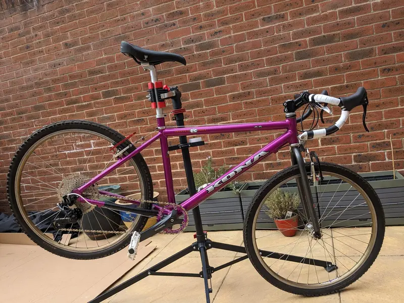

Quick update as I managed to get some bulid progress in this weekend:
- Shifter installed and cabled up - just need a Shiftmate (on the way) to enable full indexing. happy the deraileur can cope with the monster cassette.
- Position seems good and rides nicely. Maybe it's just the feel of drop bars and big tyres but acquring nicer rubber will be a medium-term aim.
- Narrow wide chainring installed, chain line seems good but will know for sure after Shiftmate installed.
- Brakes working well (crosstops installed) but pads need further fine tuning, hoping to get minor wobble in rear wheel ironed out this week which will help.
- Then black/purple bar tape to install and she'll be ready for the canal path!

Looking good 👍🏻 I like those brakes.
