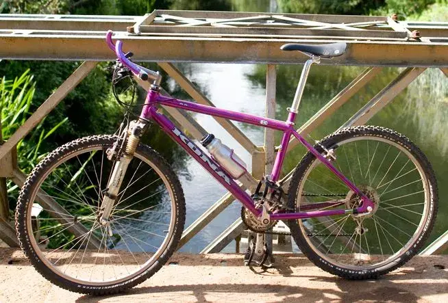

And here's what she looks like at the moment (will deffo post one when the rebuild is finished):

Looks great as it is tbh, but I'm sure it'll look good with the new stuff on too :)
