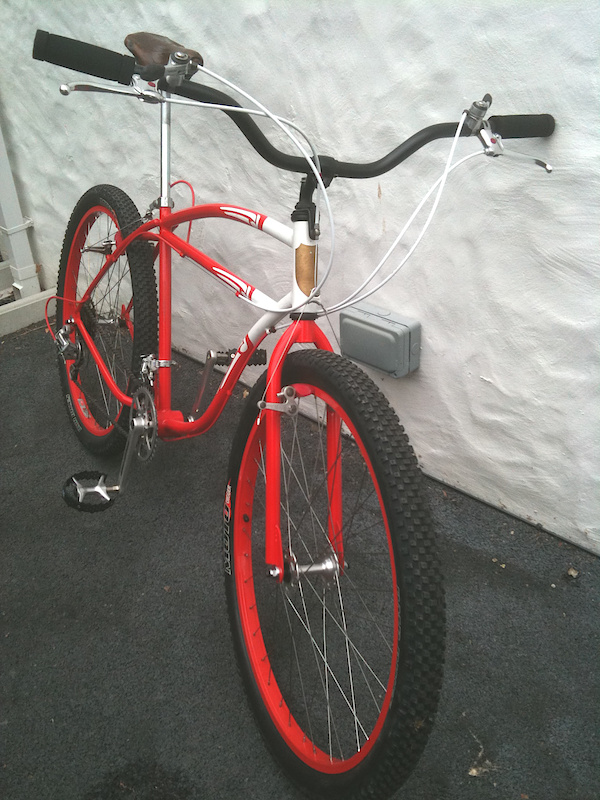

After much work and loads of help for the forum (DRS, j-westy and others) and Alan bond (told me where to get rare parts (how good is that) i finaly finished my paint and got all the parts together here is the finished bike:
later 1940's-early 50's schwinn DX frame, enamel paint, Lasante badge
Cooks Brothers cruiser forks from BMX museum
Nikko NOS headset
Ashtabula stem
Renthal bars
Ritchey foam grips NOS
Dia- compe levers
Suntour shifters
Suntour 7 mech (1") NOS
Suntour vx cyclone mech
Suntour 5speed block NOS
Mafac cantis with ritchey pads
DMR bb converter NEW
Shimano bb NEW
TA cranks
Brooks saddle
Harris seat post NOS with tubing brazed inside for strenght
Shimano large flange hubs NOS
DT spokes
Weinmann rims NOS
DMR digger tyres
Jagwire cables
Oddissy pedals NOS
Pick here is your are interested:
Thansk for everyones help and enthusiam. This was a tricky build and by no means as good as some of the others guys build but i love it and it ruides pretty good too.
Happy trails
Pete

bmx4130crmo":2no04hlq said:
nice and beautiful, thumbs up!
but why you didnt have weld a canti cable stop at the seatstays?
ha ha, good point. i woudl not do that agin. i was going for a ultra minimal cable route usign a shimano cable bridge to centre. unfortunaly i did not do the masth for the mafac cantis and the cabel set up did not work. doh! you live and learn.
