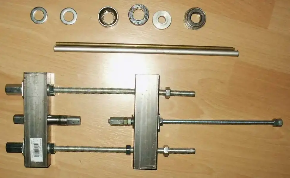

i have changed a few Klein spindles with a rubber mallet and some lumps of wood...
or you can make one of these.... :)
There is a Klein manual on line somewhere explaining exactly how do do it... i used to have a copy but i cant find it... sure someone will post the link for you.

Thanks to 24pouces and magicmistertea for the pics.
Mallet method worked....I have got the spindle out.
