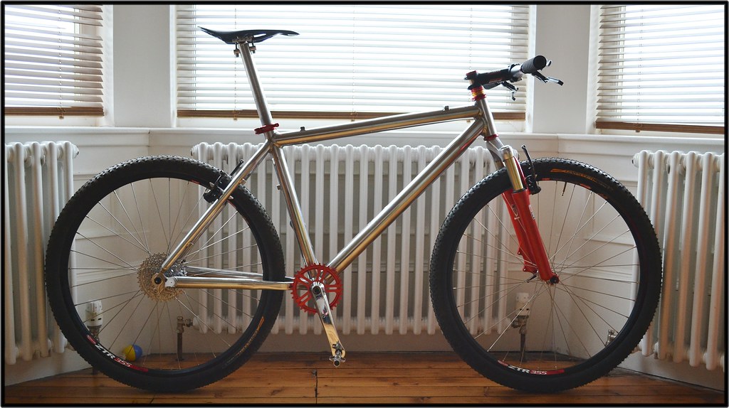

Cheers guys, it stalled a bit there, I have a 9 speed thumbie and 9 speed cassette but as I went to fit it found I had only a 7 speed freehub :roll: Anyway its prompted to me to build a new pair of wheels. Stans 355's with Hope Ti hubs probably on rev's. Should shed almost another pound though I did quibble about the retro/modern mix.

Lamentable progress on this one. New wheels fitted and stem swapped put. I've also been waiting on a mech which feels like forever :? . Anyway now at 17.18lbs as you see it. Only mech, chain and cables to go.
Looking clean, I'd like to see it with red walls on just out of curiosity!

Alas Rampage its still sitting waiting to be finished. A bit of ebay woe with a rear mech saw this one going on the back burner and then I started eyeing up bits for another bike. Good news is I never went backwards with it and its back on the agenda as I try to get all my nearly complete bikes complete. I was going to compromise the weenieing and just get it going but I think I'll keep at it :)
