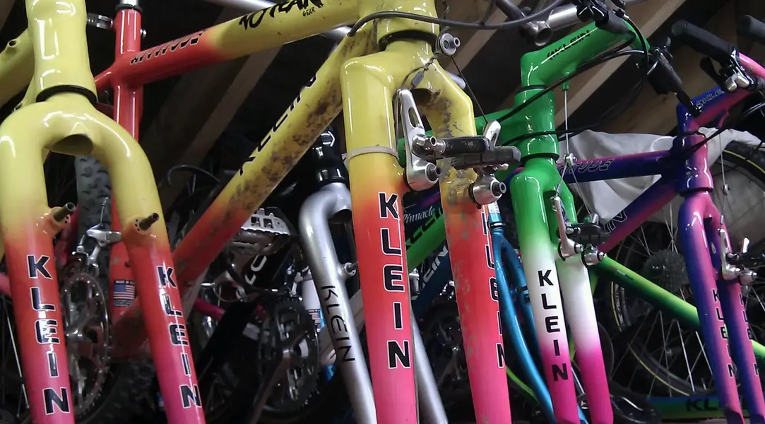

What do the fork decals look like?
With outline too:
I´ve only seen a couple more box fork Dolomites on the web. Most of the bikes showing the outlined decals, have a Uniklein fork.
Here is a few examples, box fork with solid black, box with white outline, uni with white outline.
